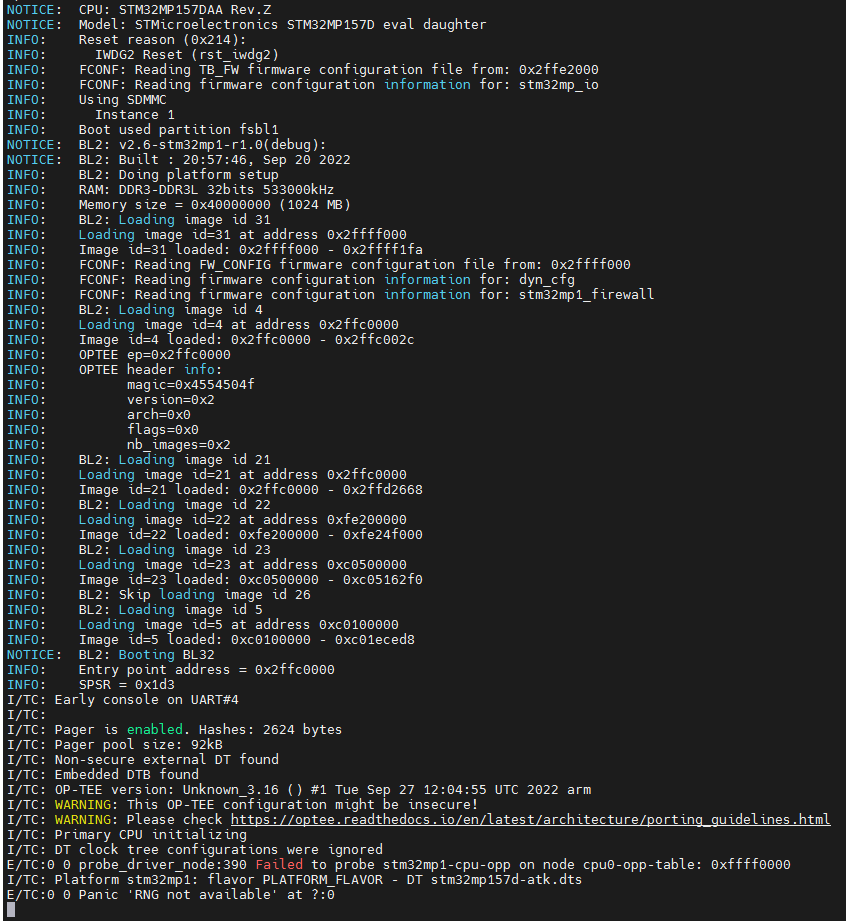

When porting the boot on my board,Please analyze the following situations:

Is it because the power supply I use is fixed?
There is no PMIC on my board

Do you have the device tree file with independent power supply for reference?
