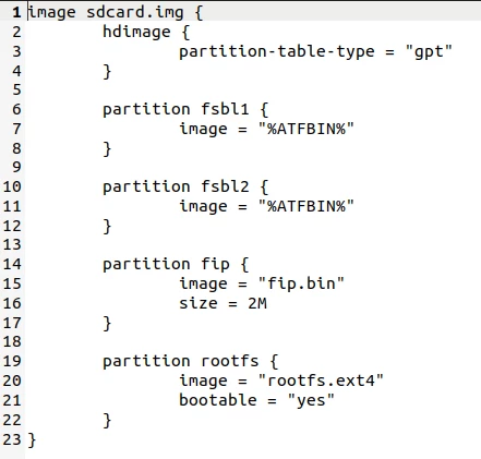

I am trying to flash a eMMC with STM32CubeProgrammer, in a STM32MP157F custom board. I am using a GPT partition file and a img.
I can see the system is creating partitions and flashing, but the structure is wrong for eMMC, so it does not boot-up. Sometimes, trying different structures, I get an error "wrong memory layout" in the console when I am trying to flash.
The tsv file I am using at the moment is:
And the gpt table is as follows:
I believe the solution is in the right configuration of the table, can somebody detail on how to do it?

I advice you to take a look at this article that explain the different flashlayout depending on the boot memory used : https://wiki.st.com/stm32mpu/wiki/STM32CubeProgrammer_flashlayout

Thanks for your suggestion, solution was actually there. I took out the first 2 partitions out of the GPT and program them individually in the CubeProgrammer (partitions 4 and 5). Thank you!
