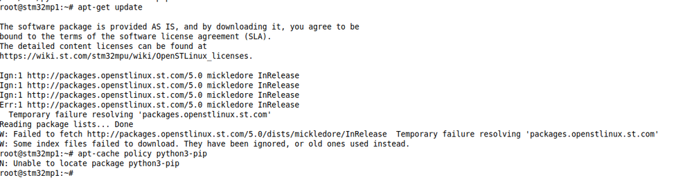

Thank you for your reply, the same error unable to locate package python3-pipScreenshot from 2024-02-08 14-28-39.png
Sound like your board is not connected to the Internet (RJ45 or WLAN)
Tip of the day: Try Sidekick STM32 AI agent, see here
Hi @PatrickF
I will check that thank you for your reply
Hi @PatrickF

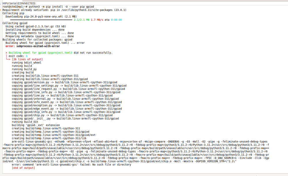

apt-get install python3-pip  is working now Thank you , but when I try to install libgpiod i got this error .Screenshot from 2024-02-13 14-58-13.png
Any idea ?
Hi @Softcity
please try
 apt-get install python3-gpiod
