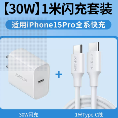

I bought another power cord:
The previous log is no longer printed:
Previous ADC measurements was not the one expected, retry in 20ms
*    WARNING 500mA power supply detected     *
*    Current too low, use a 3A power supply!        *
The complete log is attached "log2024.06.26.txt".
Looking forward to your reply.
Regards
