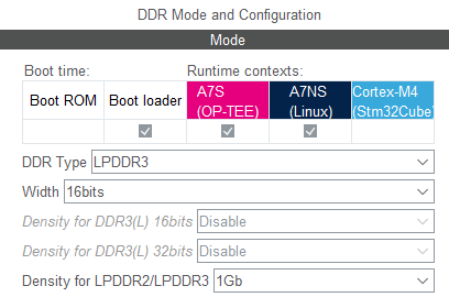

In addition to this, I tried to use CubeMX DDR Test Suite. Having a running SPL I managed to connect to it. The tool correctly recognises the DDR as:
Config name: LPDDR3 16bits 533000kHz
DDR Size: 1 GBits
DDR Frequency: 533.0MHz
Then it stops cooperating with:
Exception in thread "Thread-4843" java.lang.ArrayIndexOutOfBoundsException: Index 1 out of bounds for length 1

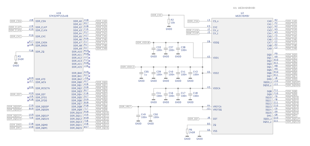

Hi @qyx​ ,
could you share your schematics around supply/ref/signals around DDR interface (both STM32MP15x and LPDDR3 side) ? Sometimes a fresh eye could find mixed up signals (we have the case from time to time).

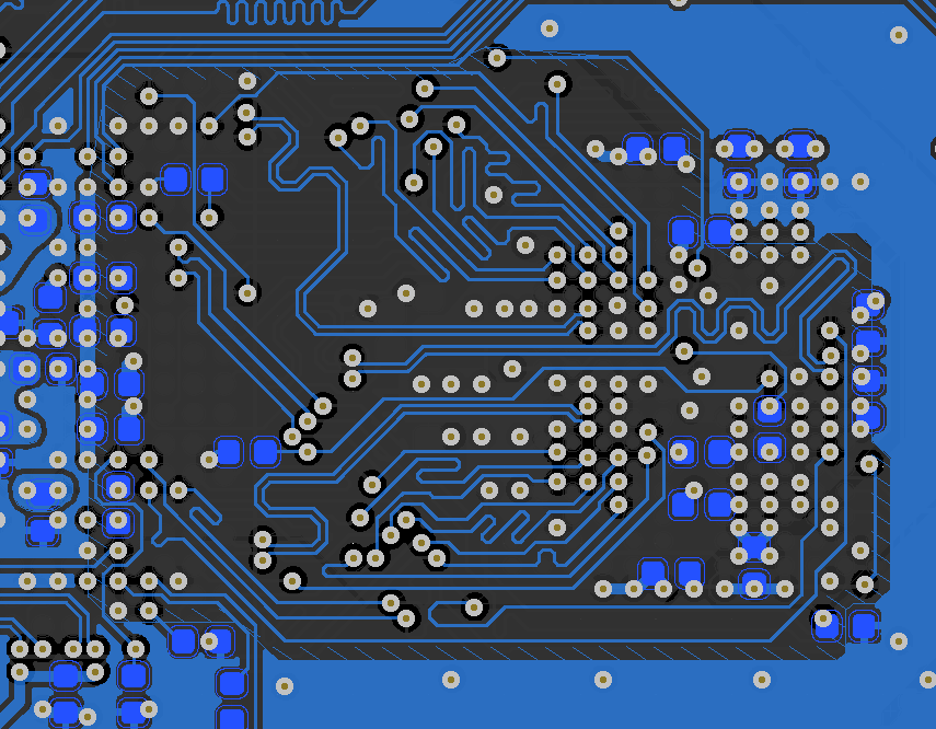

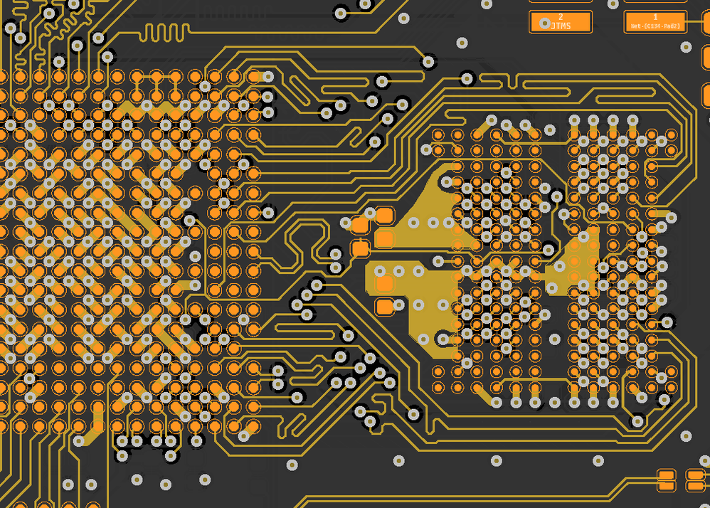

I have read the mentioned app notes, the only thing I overlooked is the 100R termination resistor on CLKN/CLKP. I added it directly on vias under the LPDDR3 chip now but still no luck.
Regarding the software, u-boot in the v3.1 ecosystem is very old. I was using the upstreamed support in the v2022.04-rc4. I will compare the changes to v3.1 ST's u-boot.
I am attaching the schematic cutout and routing. Individual tracks within byte lanes are matched to 0.1 mm, DQ0-7 is 18 mm, DQ8-15 is 16 mm, CA is 30 mm (the difference of 14 mm is a bit marginal).
0693W00000LvwpeQAB.pngTop layer:0693W00000LvwqhQAB.pngBottom layer:

Hi, you schematic sound ok. I assume the DDR_VREF is also connected to STM32MP15x.
I confirm the 100ohms on DDR clock was missing in AN5031 (but listed in AN5122 and in our schematics PCB examples).
Otherwise, I cannot comment more on SW version aspects as I have an HW focus.
Tip of the day: Try Sidekick STM32 AI agent, see here
qyx
Thanks for confirming the schematic is correct. Yes, DDR_VREF is connected to STM32MP15x too.

It can be seen that the width is correctly set to 16 bit, despite that CubeMX generated MSTR register value 0x00040008 corresponding to a 32 bit wide DDR. The correct value should be 0x00041008 (half DQ bus width) according to the datasheet.
which version of CubeMX are you using ?
Tested on v6.4 (the one which must be used with Ecosystem v3.1) and give me MSTR value of 0x00041008 .

I am using CubeMX 6.5, downloaded a fresh one. I tried both your DTS files with similar results. So I changed the DDR clock to 200 MHz, somehow managed to generate the correct DTS and modified DDR test 3 to get some insight to what can be read from the memory.
