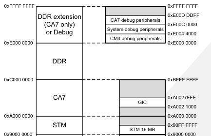

The memory 0xdf800000 is inside the DDR memory

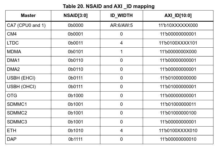

When I'm looking inside the datasheet and converting 0x4a0 and 0x480 to binary. Which becomes:
0x4a00x480
1001010000010010000000
So I guess it has to do with the CPU?

 Question:
If I'm correct, that my linux kernel, or linux distribution, cannot write och read to the CPU. That means I need to configure that in the device tree? Right? So what chould I change inside the device tree to make premissions for my software to write or read to the address 0x4a0 and 0x480 inside the CPU?
Should I add this inside the Linux Device Tree?
	reserved-memory {
		#address-cells = <1>;
		#size-cells = <1>;
		ranges;
		/* USER CODE BEGIN reserved-memory */
		optee@de000000 {
			reg = <0xde000000 0x2000000>;
			no-map;

Yes!
This code need to be placed inside the Linux Device .dts file! By the way! I'm using STM32-OS https://github.com/danielmartensson/STM32-OS instead of OpenSTLinux. Memory usage is about 40 MB in RAM.
reserved-memory {
		#size-cells = <1>;
		ranges;
		optee@de000000 {
			no-map;
