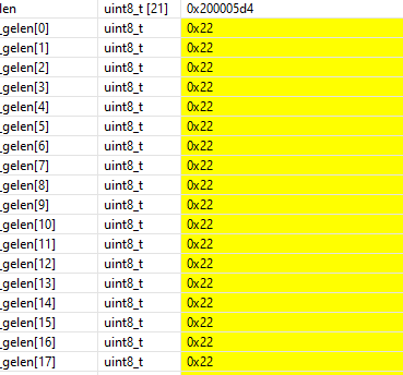

I'm using STM32g491 and rs485 modules. I'm trying to transmit data from uart1 with DMA when I receive data. There is a dilemma it transmit data but also does not? When I try to send a buffer which defined on stm's code, it transmits but when I try to transmit data come through GUI, it does not transmit. There is no problem about data coming from GUI. I can see it when I debug. Here is my code and the data coming from gui on debug

I write a GUI with C#, I check if data come from guı from STM's debug and every time I send I can see it on debug.
When it comes UARTs, I know it bcs I'm also wathcing transmit and receive data simultanously with logic analyzer. I can see receiving data, but can't see transmit data. It transmits 3-4 packeges then it stops because of flags. I set these flags every time it comes in RxCallbacks.
