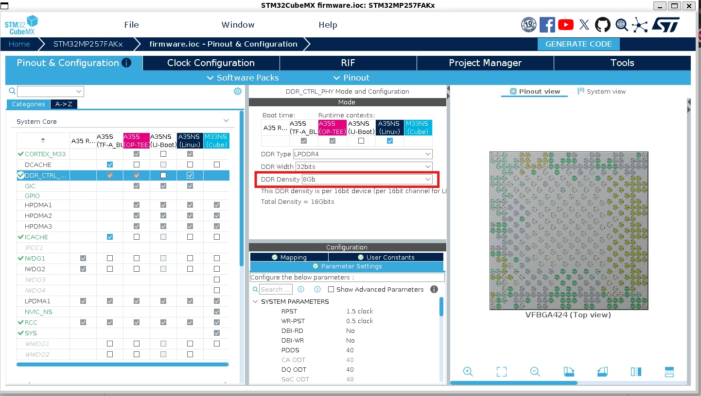

I have a STM32MP257F custom board with a MT53E1G32D2FW-046 WT:C (4GB) memory.
But when I'm booting the TF-A, then I get this message. Notice that this processor passes the DDR data(stm32mp_ddr_test_data_bus(void)) and DDR rw(stm32mp_ddr_test_rw_access(void)) test! So I don't think that the assembly was bad.
ERROR: DDR addr bus test: can't access memory @ 0x100000000
BACKTRACE: START: stm32mp2_ddr_setup
This means that my CPU cannot access the address 0x100000000. This limit is exactly 4GB.
If we looking at the code. That means that the offset variable must be 0x80000000, which is 2GB. The function stm32mp_ddr_test_addr_bus(size_t size) is beging called with size = 4294967296 = 4GB.

PatrickF
February 13, 2026
We did not have such message on our DK board having exactly same memory.
Warning, Micron device revision must be C.
The B will not work as it is a dual rank which is not supported by STM32MP25 (might explain why half of the memory is not accessible).
I'm not expert on SW, but you might not need to touch what is working on Starter Package.
Did you you use same .dtsi file and same PCB interconnections than our STM32MP257F-DK board ?
Running https://wiki.st.com/stm32mpu/wiki/STM32DDRFW-UTIL could help to identify more precisely the issue.

Hi @PatrickF
I just want to give you a reply so you and the ST Dev team can understand the "solution".
First I changed from 16-Bit density (4 GB RAM) to 8-Bit density (2 GB RAM) and it's working.
INFO: Memory size = 0x80000000 (2048 MB)
My question for you is: Assuming that I bought a MT53E1G32D2FW-046 WT:B memory and I can only use the half of the density....is it possible to modify the TF-A software etc so I can use its fully density?
