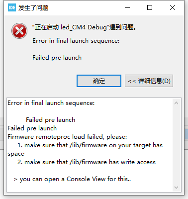

I reported the following error when debugging the M4 kernel of STM32MP157D using STM32CubeIDE:
After my troubleshooting, I found that there was a problem with the file permissions when uploading the script "fw-cortex_m4.sh" from STM32CubeIDE. On the computer, the file permissions were "- rwxr-xr-x", but after uploading it to my board through STM32CubeIDE, the file permissions changed to "- rw-------" and I lost my executable permissions.
Does anyone know how to solve this problem?
