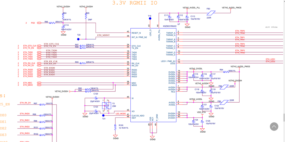

An urgent problem occurred in stm32mp157. I used ksz9031 network chip, but it could not be used. The LOG is as follows,
[ 18.996823] Micrel KSZ9031 Gigabit PHY stmmac-0:00: attached PHY driver [Micrel KSZ9031 Gigabit PHY] (mii_bus:phy_addr=stmmac-0:00, irq=POLL)
Starting Wait for Network to be Configured...
[ 19.122107] stm32-dwmac 5800a000.ethernet: Failed to reset the dma
[ 19.127072] stm32-dwmac 5800a000.ethernet eth0: stmmac_hw_setup: DMA engine initialization failed
[ 19.135979] stm32-dwmac 5800a000.ethernet eth0: stmmac_open: Hw setup failed
I can't solve this problem

See https://wiki.st.com/stm32mpu/wiki/Ethernet_overview#How_to_debug
This error is usually linked to a clock not active on the ETH IP boundary when the reset is requested (see RM0436, look at RCC section "Clock distribution for Ethernet (ETH)"). E.g. check if clocks are present on ETH_CLK125 and ETH_RX_CLK pins.
Is your PHY set-up in similar way that the one on EV1 (MB1262) or DK2 (MB1272) boards ? You could also see AN5031.
Check also if you PHY is powered at the time of the ETH reset.
‎2019-07-29 1:47 AM
- This is my ksz9031 circuit diagram
‎2019-07-29 2:53 AM
CLK125_NDO (125MHz clock from PHY) should normally be connected to ETH_CLK125 pin (PG5).
if you omit that intentionally, you need to feed internally the ETH with a precise 125MHz clock from RCC pll3_q or pll4_p (this might constrain your clock tree choices) and do the relevant settings in the DeviceTree (see https://wiki.st.com/stm32mpu/wiki/Ethernet_device_tree_configuration)

the pin 41 of KSZ9031 should provide the 125 MHz clock to STM32MP1 (and this is the simpler and preferred solution), but in your schematic it is instead connected only to a test point.
If you cannot rework your board, you need to provide the 125 MHz internally in STM32MP1.
Check the STM32MP1 Reference Manual at chapter 10.4.8 "clock distribution for Ethernet (ETH)".
The input named "ETH_CLK125" is the one missing in your board, so has to be replaced with a 125 MHz clock arriving from pll4_p_ck or pll3_q_ck. Now we need to set all the internal switches to achieve this.
