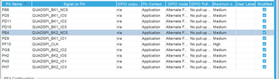

I am configuring with QuadSPI Dual and encountering an issue where it remains in a busy state and does not resolve.
The circuit is not properly connected yet, so I am currently only testing the pin output.I want to output to Bank2 IO.
I initialized it as follows:

Best answer by SL1
Changing sCommand.DataLength to 0 in static uint8_t XSPI_WriteEnable(void) fixed the issue and it now functions correctly.

SL1AuthorBest answer
June 19, 2024
