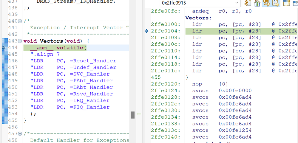

I modified an FSBL example to get to the root of the problem (everything else being as in the example).
volatile int rrr = 0;
void SGI0_IRQHandler(void) {
 while (1) {
 rrr++;
int main()
 HAL_Init();
 SystemClock_Config();
 IRQ_Disable(SGI0_IRQn);
 IRQ_SetPriority(SGI0_IRQn, 0);
 IRQ_Enable(SGI0_IRQn);
 while(1) {
	 GIC_SendSGI(SGI0_IRQn, 1, 0);
This works perfectly in thumb mode, but when I switch to ARM (that probably should give slight performance boost for my DSP task), the interrupt is stuck in Vectors section, without doing anything.
The LR is weird, and I cant get my head around how is it possible that is has LR = 0x2ffe0106 (not multiple of 4)
As if the core switched to thumb mode without address being odd and started executing instructions in 16 bit mode.
Thanks for any advice :)
Best answer by bsvi
Found the cause, I it's actually a bug in ST's code. So, the reason is that all startup_stm32mp135fxx_ca7.c files unconditionally enable interrupt handling in thumb mode with this line:
"ORR R0, R0, #(0x1 << 30) \n" /* Set TE bit to take exceptions in Thumb mode */
While startup_stm32mp135fxx_ca7_azurertos.c do it depending on ARM_MODE define.
