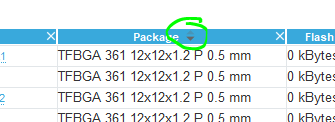

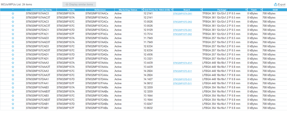

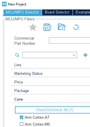

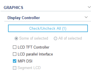

I have no idea about those big processors but i do know how to use the MCU selector from CUBEMX
File>new Project
filter to:
- Application processor like the Cortex A53.
- MIPI CSI2 interface
- Small as possible.
- BT5 connectivity abilities.
You would need extra hardware for that.
Result:
