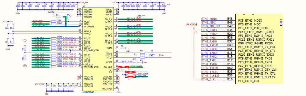

Thanks for pointing that out. I'm attaching the schematics for the PHY connection to help clarify things — just note that they don’t show the strap resistor used to set reg = <12>; that was added later.
You're right, I don’t have a reset-gpios declared in the device tree, because in my design the RESET (pin 43) of the DP83867 is tied to GND through a 10nF capacitor (C10), which handles power on reset behavior.
I do have a signal connected to PWDN (pin 44), but it's not currently used in device tree— this pin puts the PHY into low power mode, which I don’t need right now, so it's left inactive, always tied to 3V3.
I don’t think the issue is related to reset — the PHY seems to be responding. When I plug in a cable, the link is detected and the PHY link/activity LEDs light up correctly, so it doesn't appear to be stuck in reset or powerdown.
Let me know if anything in the schematic looks off — happy to double-check.

I was finally able to identify the cause by carefully probing each signal with an oscilloscope and comparing it to the reference design.
It turned out the issue was not related to the lack of a dedicated reset pin for the PHY — the power-on reset using a properly selected capacitor works just fine for this setup.
The real problem was a misconfiguration of the strap resistors, specifically those related to the MDIO delay mode. Their values were chosen very unluckily and should not have been installed at all (R4/R5/R6/R7).  Based on the PHY requirements, the delay for TX_CLK and RX_CLK must be in the range of 1.0 ns to 2.6 ns (1.5 ns to 2.0 ns is a safe zone).
On my layout, the strap resistor combination selected an invalid mode, which effectively pulled the MDIO line low, similar issue was described here. As a result, the PHY failed to expose its registers properly during initialization, causing the driver to be unable to attach.
Once I corrected the strap configuration to match a valid delay mode, everything started working as expected.
