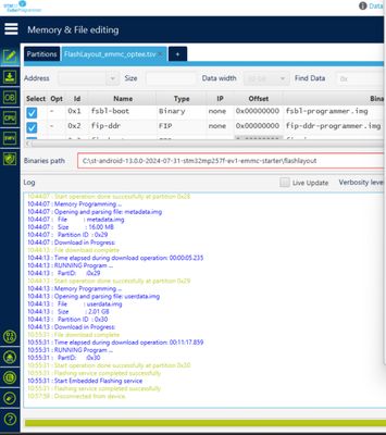

    I have flash the Android images(st-android-13.0.0-2024-07-31-stm32mp257f-ev1-emmc-starter) on the STM32MP257-EV1.

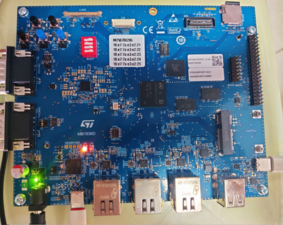

When booting the board(power supply by 5V3A adapter), the leds light as this status,is the board working normally?

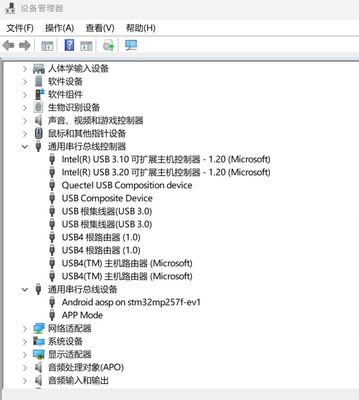

When the board booted and CN15 usb connected with PC , I found the device manager show the "Android aosp on stm32mp257f-ev1".When CN21 usb connected with PC, device manager shows up nothing new at all

    When I first boot the board, there were two virtual COM ports  appeared on the PC when connected to the ST-Link USB CN21 (STM32MP257-EV1's defualt image is OpenSTLinux?). But the second time I booted the board, there were  no virtual COM port  appeared on the PC. And then I flash the Android image on it, and it has no virtual COM port too. I wonder if my STM32MP257-EV1 board has some issue? How can I verify my STM32MP257-EV1 board whether work in normally status or not? Should I flash the default OpenSTLinux image? How can I flash the default OpenSTLinux image.
Board STLINK virtual COM ports are completely independent of flashed image (it could be seen as an external Serial<->USB converter, like it is for an external ST-LINKV3-SET). They work as soon the USB is connected and recognized correctly as a valid USB.
Maybe check your USB cable (sometimes, there is USB charging cables without data lines).

   Thanks for your suggestion, I power the board with tpye-c USB cable, and COM ports appear on the PC now.
