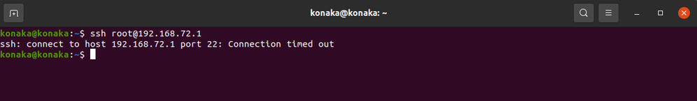

On the host computer, i try to connect the terminal to the STM32MP157F-EV1 board using ssh with Ethernet cable but I can't access
I use STM32MP157F-EV1 board. I set manually the IP adress of board with
Board $> ifconfig eth0 uuu.***.yyy.zzz
then I try connect ssh root of board with this command on my Terminal:
ssh root@xx.xx.xx.xx
and then I get
ssh: connect to host xx.xx.xx.xx port 22: Connection timed out error.
 How i can fix this issue. Can anyone help me?

Hello
I have already reviewed two pages the two pages you have sent.
If I explain step by step what I did:

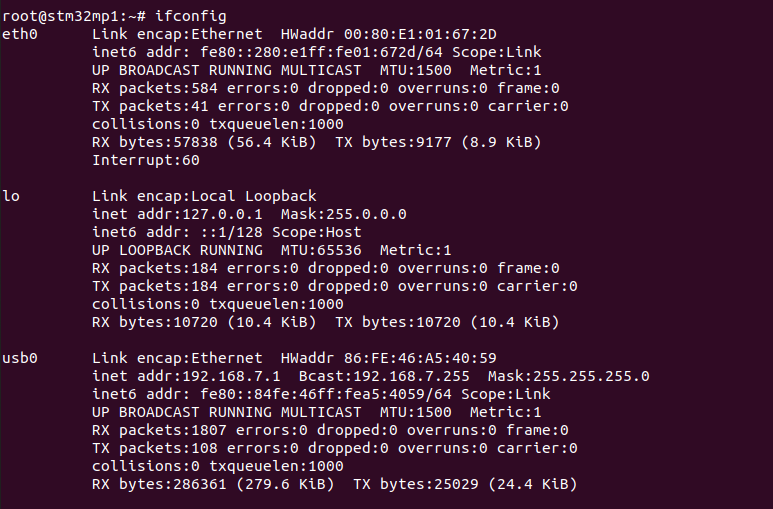

Firstly command "ifconfig" on my board:
Ifconfig responds eth0 that has not IP adress. Therefore I set manually IP adress this command and type ifconfig again:
Finally on my host computer, I want to connect the terminal to the board using ssh:
I take ssh: connect to host 192.168.72.1 port 22: Connection timed out error

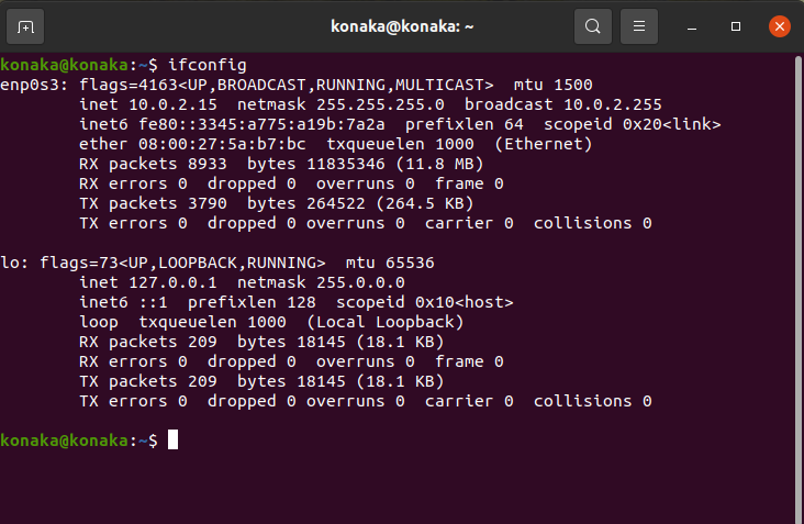

The command ifconfig on my Ubuntu PC
Thanks

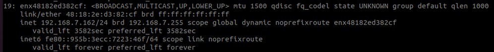

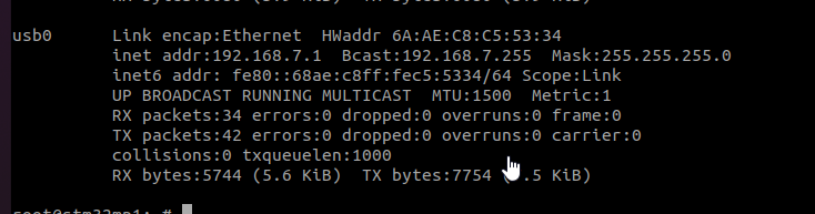

From what I see with your screenshot, you don't have a subnet shared between your board and your PC so you can't communicate between them.
For example, on my PC with my DK2 plugged via usb0 (ethernet):
0693W00000NppfYQAR.pngThe IP of the board is 192.168.7.1
and on my PC Ubuntu:
0693W00000NppfnQAB.pngMy IP is 192.168.7.162
The subnet of my PC and my board is : 192.168.7
So they are able to communicate together:

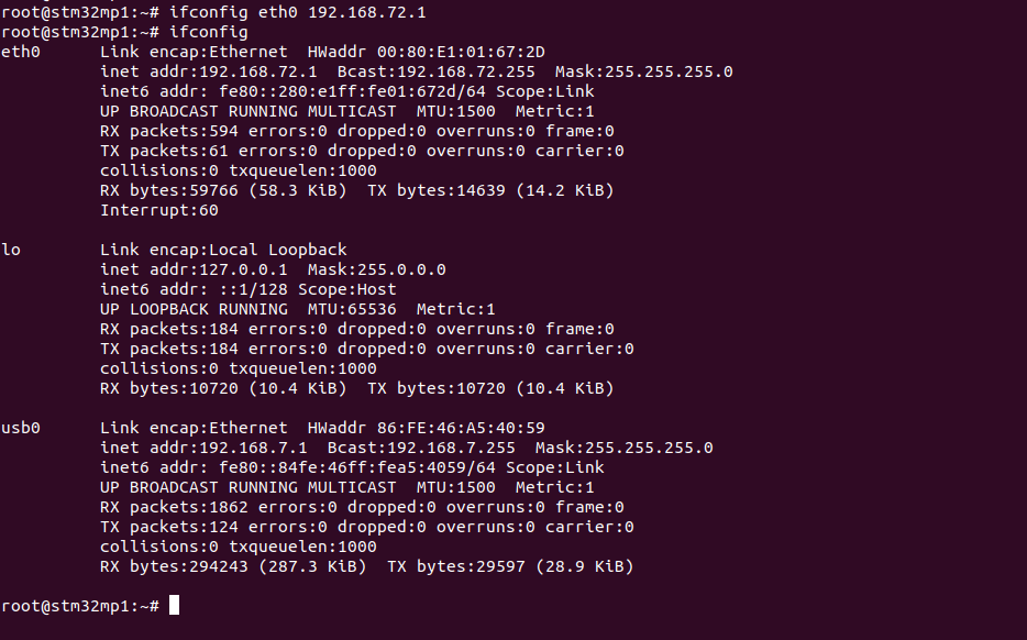

Hi
I tried this command as
$ sudo ip route add 192.168.72.0 via 192.168.72.1
but still there is no connection between Pc and Board.
I configure eth0 as Static IP Adress:
$root@stm32mp1:~# ifconfig
eth0      Link encap:Ethernet  HWaddr 00:80:E1:01:67:2D
          inet addr:192.168.72.2  Bcast:192.168.72.255  Mask:255.255.255.0

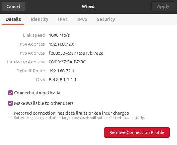

And I configure my Host PC IP Adress as Static IP Adress:

command IP route on my host Ubuntu PC:
$ ip route
default via 192.168.72.1 dev enp0s3 proto static metric 20100
169.254.0.0/16 dev enp0s3 scope link metric 1000
192.168.72.0 via 192.168.72.1 dev enp0s3
192.168.72.0/24 dev enp0s3 proto kernel scope link src 192.168.72.0 metric 100
Regards

PING 192.168.72.2 (192.168.72.2) 56(84) bytes of data.
^C
--- 192.168.72.2 ping statistics ---
22 packets transmitted, 0 received, 100% packet loss, time 21621ms
The ping test is not performing successfully.
The thing I'm wondering about is:
Is necessary USB-OTG connection to between Board and PC for ethernet connection with ethernet cable (eth0) and why it is necessary?
Regards
