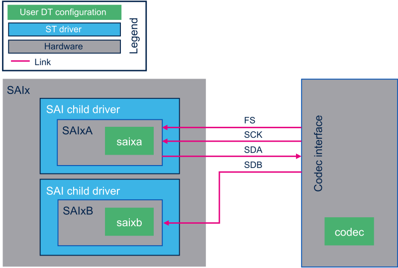

Hello everyone,
I am trying to replicate this approach to integrate STM32MP1 with an external audio codec.
0693W00000Sw5BHQAZ.pngThe issue I am facing is that the sub-block SAI-A is generating the bitclock (SCK), while I need it to receive it from the external audio codec. I am sniffing the I2S bus and whenever the audio is played, I can see the SCK being generated by SAI-A.
Could you please provide details on how to set the SAI in slave mode, so that the SCK is not generated?
Thanks in advance!

PatrickF
Hi @bimorqt​
I'm not expert, but according to wiki, it seems 'bitclock-master;' is required in the codec device Tree.
https://wiki.st.com/stm32mpu/wiki/SAI_device_tree_configuration#Sharing_the_codec_interface_between_two_SAIs
Could you share your Device Tree ?

bimorqt
Hello @PatrickF​
thank you for the quick response. I tried to replicate the devicetree provided here. Here are the most salient parts related to audio of my devicetree:

If I leave lines 40-41 uncommented, both the SAI-A and the codec generate SCK and audio playback does not work. If I leave lines 40-41 commented and lines 48-49 uncommented, the audio playback is heavily disturbed by a high-frequency noise (the source media file is basically unhearable). A working solution for audio playback is to comment lines 40-41 and 48-49, but in these conditions the audio capture does not work, because SCK is not present on the I2S bus.
