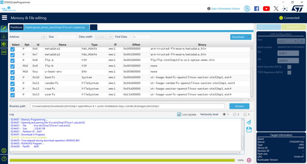

Now I have flashed the board. Is this correct?
I did not get any pop-up that saying "Flash complete"
  02:42:03 : STM32CubeProgrammer API v2.17.0 | Windows-64Bits
  02:42:10 : Read TSV File: C:\Users\danie\Downloads\stm32mp1-openstlinux-6.1-yocto-mickledore-mpu-v24.06.26\images\stm32mp1\flashlayout_st-image-weston\optee\FlashLayout_emmc_stm32mp157a-ev1-optee.tsv

Hi @DMårt ,
There is no pre-compiled OS image?
We have a starter package, but it may not work with your hardware.
If you've followed the steps in the starter package, it should work.
If you don't get a message, your eMMC was not flashed correctly, and as I said above, this is probably due to your hardware modification.

Hi! I get an error message now.
I don't know if the eMMC is broken, not soldered correctly or the software is not suitable for the hardware.
The problem with buildning own linux, is that most of the configurations gave me errors.
Update:
I notice that the eMMC was not correctly soldered. I did a reflow with my air heating gun and saw that the eMMC become much more flat because it was tilting some 0.05mm i Z-axis. So I reflowed it and move it a little bit with a tweezer and it sure looks like it fits the pads.
So it must definitely be a software issue. I reflashed the eMMC with STM32CubeProgrammer and I got the same error as below.
