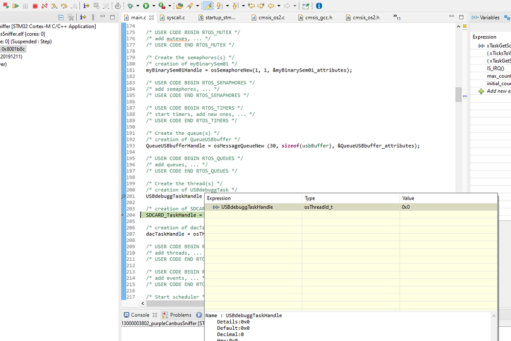

@OlivierK​ i also am having this issue right now with a
cubeMX 6.6.1
STM32Cube FW_F1 V1.8.4
cubeIDE 1.8.0
FReeRTOS v2 10.0.1
CMSIS-RTOS 2.00
running the debugger in a stm32f105RBt6
- If i run the code without startng the debugg sesion there is no problem (same debug configuration)
- once i try to start the debugg session and i place my breakpoints i get 0x0 in the handlers of every task/queue/semaphore and then osKernelStart() exits with a osErrorISR
osKernelInitialize() runs okay, returns status osOK because
__STATIC_FORCEINLINE uint32_t __get_IPSR(void)
uint32_t result;
__ASM volatile ("MRS %0, ipsr" : "=r" (result) );
return(result);
__get_IPSR returns 0;
‎2022-08-12 2:25 AM
BUT when __get_IPSR is called after oskernelInitialice() it returns a number 32.
Indicating the system is inside an interruption
Edit: after 14 times launching the debugger and changing breakpoints from place to place it suddenly works.. (no code was changed)
