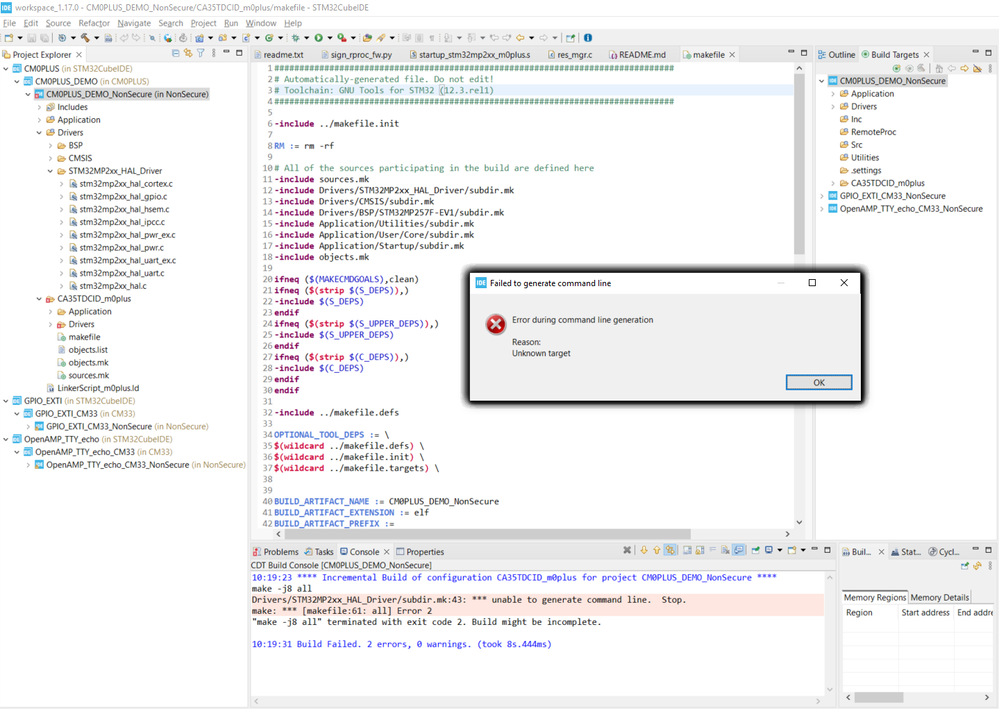

I'm trying to build CM0PLUS_DEMO for STM32MP257x-EV1 for the cortex-M0 core.

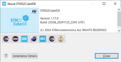

I got planty of errors when trying to build it with STM32CubeIDE Version: 1.17.0 Build: 23558_20241125_2245 (UTC):
Failed to generate command line.
reason: Unknown target.

‎2024-12-17 1:25 AM
Hi Olivier,
Which version of en.stm32cubemp2 and CubeIDE are you using?
I'm using windows but a partner is using ubuntu 20.04 and got the same error:

Just clicking C/C++ Build --> Settings --> MCU/MPU Settings..... produce the same errors screens as when building:
Error during command line generation
Reason:
Unknown target
‎2024-12-18 12:09 AM
