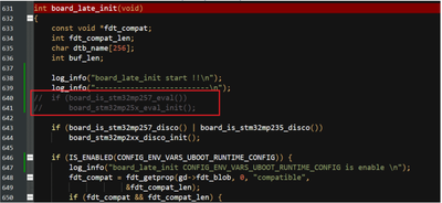

Hi @Erwan SZYMANSKI ,
After modified the u-boot board driver stm32mp2.c, the backlight could be enabled.
The main modification is to remove the part that determines whether the panel with stm32mp25 preset support is detected.
I'm not sure if this modification is reasonable. Please help clarify it. Thank you.

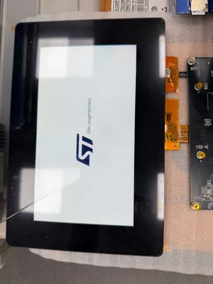

I confuse that if u-boot pixel clock is fixed? I found some message in stm32_ltdc.c driver, it notes "TODO Below parameters are hard-coded for the moment..."
Now, I set abnormal panel-timing can work on u-boot, but it cannot work on kernel. I attached the panel pictures. 
In u-boot:
In kernel:
Thank for your help.
Hello @Tim_ho ,
So as far as I understand and see, your remaining error looks to be something around your panel timing. Do you have the specifications of the panel ?
Your timings should be aligned between U-Boot and Linux kernel by the way, if continuous splash screen is used, there is a possibility that timings are not reset at Linux stage.
