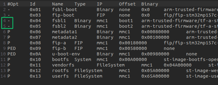

Step 1. The emmc....tsv file modification
0693W00000SuoZPQAZ.pngJust remove P in lines 4 and 5 and type -. Suggested create a copy of the original file because in next compilation file will be again replaced to the original content.
Step 2. Generation *.raw file
./create_sdcard_from_flashlayout.sh ../flashlayout_st-image-weston/trusted/FlashLayout_emmc_xxxx.tsv

I think I have a procedure, but it is complicated a little bit

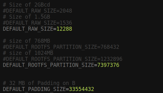

One more thing finally, to be able to store the new prepared *.raw file into /usr/local it is necessary to extend sd-card /usr/local partition. I do it like that in the file create_sdcard_from_flashlayout.sh
0693W00000SuobkQAB.pngbut this is only for the Sd-card for the EMMC go back to Your settings.
