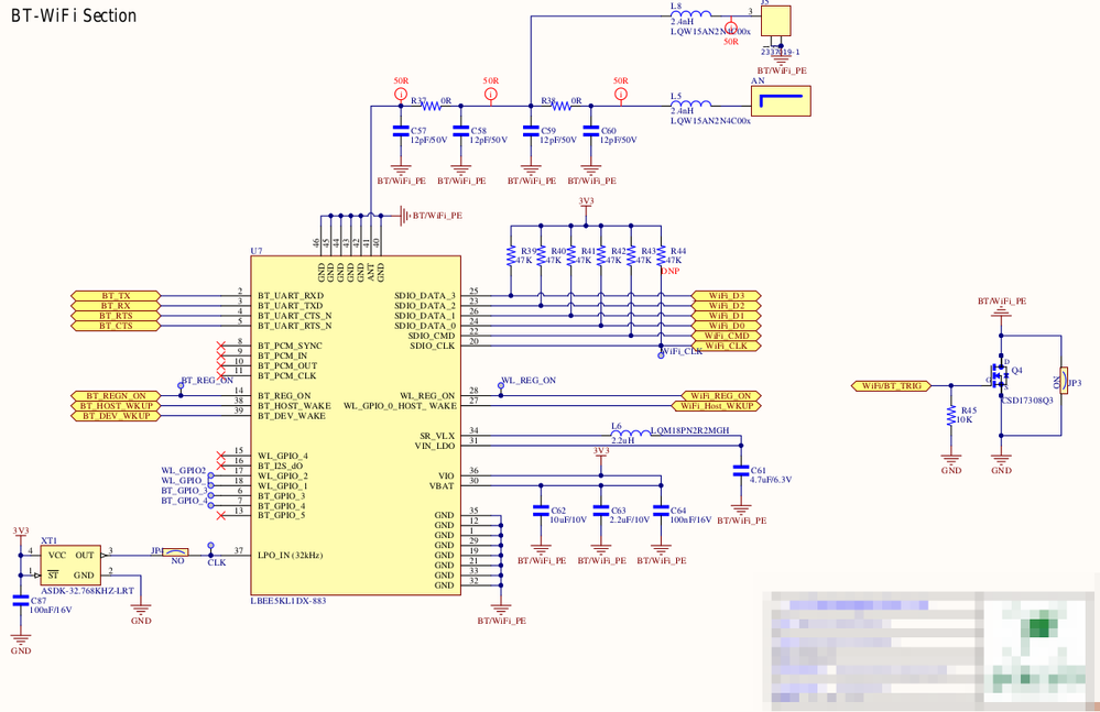

We have designed our own custom board by taking the reference of the DK2 board, in which we're using the LBEE5KL1DX-883 WiFi/BT module from Murata at SDMMC3
somehow, the module is unable to detect!
after dmesg of the MMC log, I got to know that the SDMMC 3 is not initialized
here is the mmc dmesg logs

From the logs snipped you can see that the mmc initialization is failed with error code 22 !
My DTS file configuration is shown at below

Hi @Mahendra Sondagar ,
Did you check you HW by confirming the module is powered and clocked ?
Else could you clarify what you mean by "I'm deleing with the older BSP without TF-A (4.19.49)"

2021-07-13 12:53 AM
Hi.. @Community member
Thanks for your feedback
I'm using a 32.768khz external oscillator with my custom board
yes, the board is clocked well, as I have confirmed with the analyzer
I have also confirmed the high to low transaction of the WL_REG pin during the boot time
My kernel version is 4.19.49 without TF-A. it means I have zImage, uboot+spl & rootfs only
yes, you're right it's an older one
But, right now I'm intended to test my application on the existing BSP which I got from my SOM manufacturer because of some strict timeline of the project
here I have attached the screen-shot of the WiFi section of my custom board schematic
Note: WiFi_BT trigger load trigger MOSFET is short at the moment
Thanks & Regards
Mahendra
2021-07-13 2:50 AM
First, I kindly warn you that ST is no longer supporting solution based on DV1.2 ( kernel 4.19) moreover using the basic boot which is a non sustainable solution for product development.
If your SOM Maker still provide such solution it's under his responsibility, and it's duty to support you.
This said, I just realized I forgot to ask if you properly enable SDMMC3 kernel clock in U-Boot DT.
You should have in rcc node "st,pkcs" property something like CLK_SDMMC3_PLL4P
Olivier
