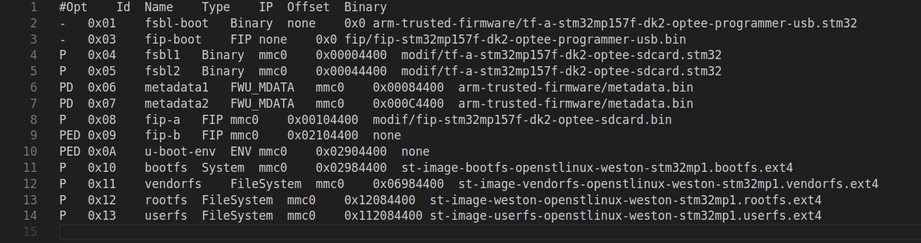

I'm attempting to optimize the boot process on my STM32MP157F-DK2 board by removing U-Boot and booting the Linux kernel directly via the FIP. I've followed the documented steps for STM32MP1:
  1. TF-A BL2 Modifications:
    • Updated STM32MP_BL33_BASE and STM32MP_BL33_MAX_SIZE in the STM32MP1 header file.
    • Increased the SDMMC timeout in stm32_sdmmc2.c to accommodate the larger kernel image.
  2. FIP Creation:
    • Recompiled TF-A with my modifications.
    • Created a new FIP where I replaced the U-Boot binary and its DTB with my Linux kernel Image and DTB.
    • The new FIP (fip.bin) now contains the kernel and DTB.
  3. Flash Layout TSV Modifications:
    I updated the TSV file to allocate a larger space for the FIP. Below is the relevant excerpt:
Despite these modifications, every time I execute the process, it fails. My questions are:
  • What is the purpose of the bootfs partition?
    Since my new FIP (fip.bin) already contains the Linux kernel and its DTB, I'm unclear why the flash layout still reserves a bootfs partition. Is it meant for additional boot configurations, an initial ramdisk, or something else?
  • Why is the u-boot-env partition still present?
    If U-Boot is being removed entirely from the boot chain, what role does the U-Boot environment play here? Is it kept for legacy or recovery purposes?
I would really appreciate any insights or suggestions on what might be going wrong or what additional changes I need to consider for a successful direct kernel boot setup on STM32MP157f-dk2.
Thanks in advance for your help!

I just took a look at it, and something surprised me. By looking at the content with fiptool info command (using SDK), I see this:
 fiptool info ./fip-stm32mp157f-dk2-optee-sdcard.bin
Non-Trusted Firmware BL33: offset=0xB0, size=0x15555CC, cmdline="--nt-fw"
FW_CONFIG: offset=0x155567C, size=0x1EA, cmdline="--fw-config"
HW_CONFIG: offset=0x1555866, size=0x20E3F, cmdline="--hw-config"
In a "normal" binary FIP, you have this:
fiptool info fip-stm32mp157f-dk2-optee-sdcard.bin
Secure Payload BL32 (Trusted OS): offset=0x128, size=0x2C, cmdline="--tos-fw"
Secure Payload BL32 Extra1 (Trusted OS Extra1): offset=0x154, size=0x10B48, cmdline="--tos-fw-extra1"
Secure Payload BL32 Extra2 (Trusted OS Extra2): offset=0x10C9C, size=0x72000, cmdline="--tos-fw-extra2"
Non-Trusted Firmware BL33: offset=0x82C9C, size=0x11E500, cmdline="--nt-fw"
FW_CONFIG: offset=0x1A119C, size=0x1EA, cmdline="--fw-config"
HW_CONFIG: offset=0x1A1386, size=0x21600, cmdline="--hw-config"
In fact, I well see your new BL33 (originally U-Boot, now the Linux kernel in your setup). The size looks coherent with a Linux Image.
I well see the U-Boot Linux DTB, that's ok.
I also see the FW config DTB.
What is missing is the OP-TEE part in fact. OP-TEE is mandatory to boot, and it is possible that TF-A raises an issue by knowing that OP-TEE must be present.
There are 2 possibilities, either you created a FIP from scratch and forgot to compile and put OP-TEE inside, or you deleted silently OP-TEE from your FIP. In the context of the wiki article, we start from the original starter FIP binary, and update only the parts that change.
Can you please try to add the missing part and ping me back ?

I am also trying to eliminate u-boot and directly boot into linux kernel. I am using yocto mickledore distibution package for stm32mp15-disco machine.
I have made the below changes in my TFA and kernel:-
1. change STM32MP_BL33_BASE and STM32MP_BL33_MAX_SIZE in my stm32mp1_def.h file
#define
 STM32MP_BL33_BASE (STM32MP_DDR_BASE + U(0x2008000))
#define STM32MP_BL33_MAX_SIZE U(0x3FF8000)
2.
increased timeout in my <tf-a_sources>/drivers/st/mmc/stm32_sdmmc2.c file:
timeout = timeout_init_us(TIMEOUT_US_1_S * 10);
3. kernel:- Added below config parameters in my defconfig file
CONFIG_CMDLINE_BOOL=y
CONFIG_CMDLINE="root=PARTUUID=e91c4e10-16e6-4c0e-bd0e-77becf4a3582 rootwait rw earlyprintk earlycon console=ttySTM0,115200"
4. After rebuilding my image with the above chamges, I
updated the FIP image using fiptool:
fiptool update --nt-fw kernel/uImage --hw-config kernel/stm32mp157f-dk2.dtb Modified-fip/fip-stm32mp157f-dk2-optee-sdcard.bin
5. below is my flashlayout:-
#OptIdNameTypeIPOffsetBinary
-0x01fsbl-bootBinarynone0x0arm-trusted-firmware/tf-a-stm32mp157f-dk2-usb.stm32
-0x03fip-bootFIPnone0x0fip/fip-stm32mp157f-dk2-optee-sdcard.bin
P0x04fsbl1Binarymmc00x00004400arm-trusted-firmware/tf-a-stm32mp157f-dk2-optee-sdcard.stm32
P0x05fsbl2Binarymmc00x00044400arm-trusted-firmware/tf-a-stm32mp157f-dk2-optee-sdcard.stm32
P0x06metadata1FWU_MDATAmmc00x00084400arm-trusted-firmware/metadata.bin
P0x07metadata2FWU_MDATAmmc00x000C4400arm-trusted-firmware/metadata.bin
P0x08fip-aFIPmmc00x00104400modified-fip/fip-stm32mp157f-dk2-optee-sdcard.bin
PED0x09fip-bFIPmmc00x02104400none
PED0x0Au-boot-envENVmmc00x02904400none
P0x10bootfsSystemmmc00x02984400st-image-bootfs-openstlinux-weston-stm32mp15-disco.ext4
P0x11vendorfsFileSystemmmc00x06984400st-image-vendorfs-openstlinux-weston-stm32mp15-disco.ext4
P0x12rootfsFileSystemmmc00x12084400st-image-qt-openstlinux-weston-stm32mp15-disco.ext4
P0x13userfsFileSystemmmc00x112084400st-image-qt-userfs-openstlinux-weston-stm32mp15-disco.ext4
When attempting to flash the image using STM32CubeProgrammer, I receive a timeout error indicating "unable to reconnect", and the operation fails at partition 0x03.
Please let me know if i need to make any other changes or how i can resolve this and get my direct kernel boot to work?
Thanks.

Any idea why i am not able to boot after flashing the image. Below is my flashlayout file i am using.
I have also attached my modified fip binary please have a look let me knwo if i am missing anything?
-0x03fip-bootFIPnone0x0fip/fip-stm32mp157f-dk2-optee-programmer-usb.bin
P0x08fip-aFIPmmc00x00104400modified/fip-stm32mp157f-dk2-optee-sdcard.bin
Looking forward to your response.
