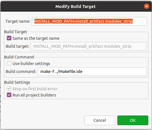

It is possible to customize STM32CubeIDE creating a makefile in the ***_CA7_linux-5.10.10/Makefile.ide
# Set default path
SRC_PATH ?= $(PWD)
BLD_PATH ?= $(SRC_PATH)/../build
modules_strip:
@cd $(BLD_PATH)
$(shell rm $(BLD_PATH)/$(INSTALL_MOD_PATH)/lib/modules/5.10.10/build)
$(shell rm $(BLD_PATH)/$(INSTALL_MOD_PATH)/lib/modules/5.10.10/source)
@find $(INSTALL_MOD_PATH)/ -name "*.ko" | xargs $(STRIP) --strip-debug --remove-section=.comment --remove-section=.note --preserve-dates
and a create a Build Target:
Hope this help,
