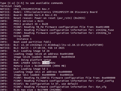

I am trying to decrease the DDR Clock Frequency for STM32MP257F-DK board. I used STM32CubeMX Tool to change clock tree and generate the modified device trees and made the required changes, compiled and flashed, but still the ddr clock remains the same.

I was able to change the frequency in arm trusted firmware but it is still not changed in kernel.
Here the 933MHZ frequency is set, but in kernel when I read clk_rate for ck_icn_ddr it is still 600MHz.
What am I missing and how can i set it properly?
