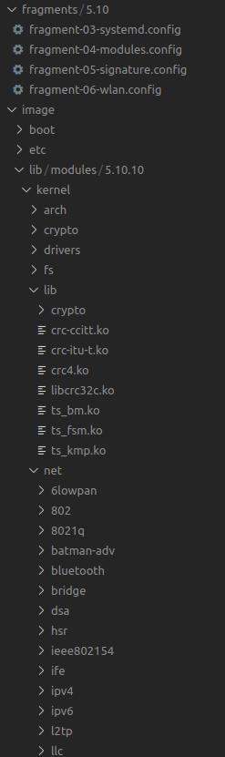

Inspecting .config in work/stm32mp1_disco-poky-linux-gnueabi/linux-stm32mp/5.10.10-r0/build shows that these changes were included.
Looking at the build folder for linux-stm32mp looks like this:
0693W00000Lya5fQAB.pngI can find all the modules and drivers that I wish to load.

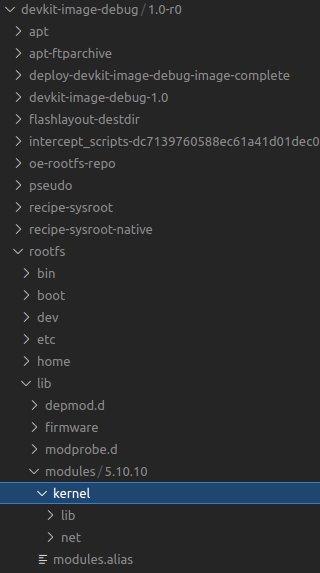

If I inspect the build folder for my output rootfs, I get this:
0693W00000Lya6dQAB.pngClearly the end result does not includes the modules and drivers I was hoping to see there. Of course flashing the image leads to the same result, thus modules cannot be loaded.
Could someone advise what am I missing?

My image was ovewritting IMAGE_INSTALL and leaving out packagegroup-base-extended \
