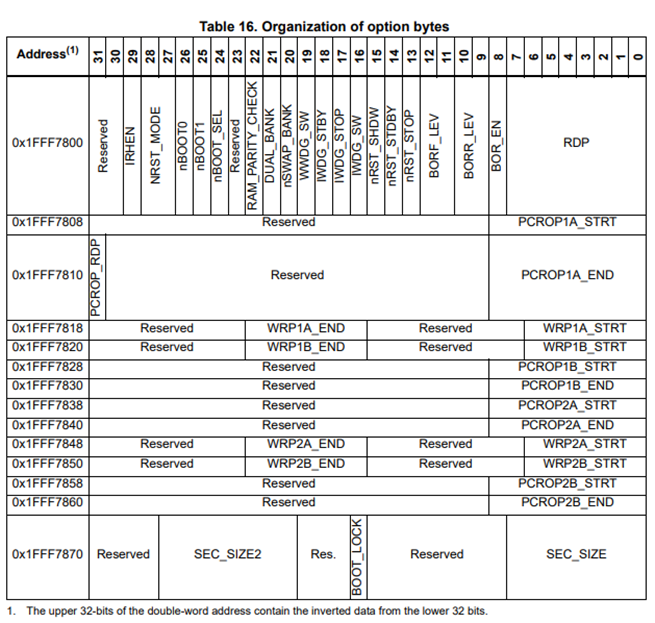

As the first step, the usual recommendation is to check the reference manual (RM0444 in this case) to get acquainted with all the possible option bytes and settings. The option bytes section in our documentation is always in the FLASH chapter, with a dedicated subchapter for it, below is a table from RM0444 showing the address and bit names:

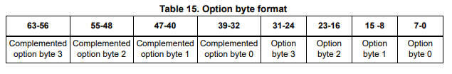

One might notice from the above table that the address increases in a 2 words (8 bytes) ratio at a time, this is because most of the option bytes have a complementary word that is verified to ensure the proper programming. In the case of the STM32G0x1, it is represented as shown here:
Alright, now that we now where to look for information in the documentation and how the option bytes roughly are organized in the memory region, we should look into how we can program them.

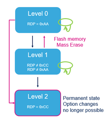

An additional detail is how the RDP works, so please refer to this image for a quick explanation:
As we can see, upon an RDP regression from level 1 to level 0, a mass erase is performed, so we need to take this into account when implementing the RDP_Regression function, because if we happen to leave it in the FLASH, the function will cease to exist before its completion and it wouldn’t work as expected, this is the reason we’ll place this function in RAM
