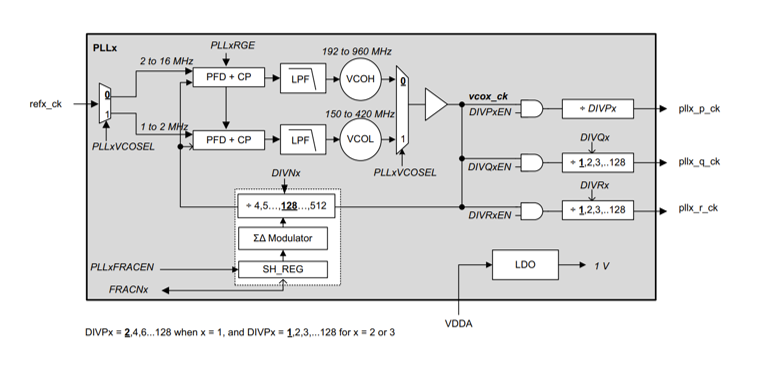

STM32H7 series have a PLL fractional (phase-locked loop) which can be updated from a DMA buffer driven by a timer.
Figure 1. STM32H7 PLL fractional block diagram from the reference manuals PLL description chapterFigure 1. STM32H7 PLL fractional block diagram from the reference manuals PLL description chapter

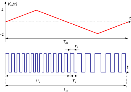

It uses Timer/DMA as a method instead. The idea is to use a table with predetermined values which will represent the type of modulation needed (for example a triangular waveform). We use this table and inject the values into the sigma delta modulator of the PLL. With the appropriate setup and sequence, the frequency of the clock changes over time. Figure 3 below shows an example.

Buffer containing the modulating signal declaration:
uint32_t PLLCFGR_Buffer[2] ={
0x70008, /*Value for PLLFCT OFF */
0x70008 /*Value for PLLFCT ON */
uint32_t PLL1FRACR_Buffer[32] ={
0x0000<<3,0x01FF<<3,0x03FF<<3,0x05FF<<3,0x07FF<<3,0x09FF<<3,0x0BFF<<3,0x0DFF<<3,
0x0FFF<<3,0x11FF<<3,0x13FF<<3,0x15FF<<3,0x17FF<<3,0x19FF<<3,0x1BFF<<3,0x1DFF<<3, 	 0x1FFF<<3,0x1DFF<<3,0x1BFF<<3,0x19FF<<3,0x17FF<<3,0x15FF<<3,0x13FF<<3,0x11FF<<3,				 0x0FFF<<3,0x0DFF<<3,0x0BFF<<3,0x09FF<<3,0x07FF<<3,0x05FF<<3,0x03FF<<3,0x01FF<<3

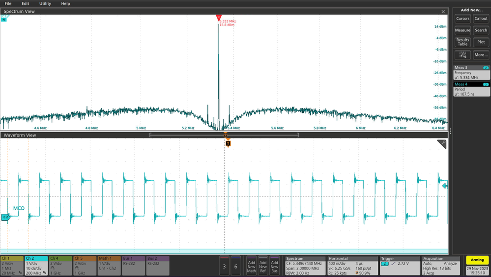

Figure 3. Clock spectrum observation on MCO output (narrow carrier)Figure 3. Clock spectrum observation on MCO output (narrow carrier)
Figure 4. Clock spectrum observation on MCO output with SSCG enabled (wide carrier)Figure 4. Clock spectrum observation on MCO output with SSCG enabled (wide carrier)

Thanks to the STM32H7 PLL fractional, timer, and DMA peripheral it’s simple to implement and shape a spread-spectrum clock generation feature. This allows to reduce the peak energy on the fundamental frequency, as well as its harmonic frequencies, keeping in mind that the generated jitter shape may not be compliant with communication standard like USB.

I have a couple questions about the operation of this:
1. In The STM32H753 reference manual, it states that when updating the FRACN register, that you need to first set the PLLxFRACEN bit to 0, then write the new value, then set the PLLxFRANEN bit to 1. Does using DMA not violate this?
2. This might answer question number 1, but what is the writing of the PLLCFGR register used for? The comments don't really describe the process here and I'm wondering if this has something to do with my above question or if there is something else in here that isn't documented? It seems like the values for the PLLCFGR register aren't listed in the code example you provided.

Hello Jason,
You are right there is a missing information here :
  1. The timer triggers the first DMA channel to copy a value from a table describing the waveform to the PLL2FRACR.
  2. The timer triggers the second DMA channel to copy two values from memory to the RCC_PLLCFGR (two writes) to toggle the Sigma Delta latch.
The DMA channels are programmed as follows:
  • The first DMA channel operates in memory-to-peripheral mode in a circular manner, pointing to the table describing the waveform and the PLL2FRACR.
  • The second DMA channel operates in memory-to-peripheral mode in a circular manner, pointing to a two-entry table with the values to be written to the RCC_PLLCFGR with the bit reset and then set.
This setup ensures that the sequence of disabling the fractional mode, updating the value, and re-enabling the fractional mode is maintained.
Therefore, using DMA does not inherently violate the procedure as long as the sequence is correctly implemented.
And yes you can use it independently, you have 3 PLL on the STM32H753.
