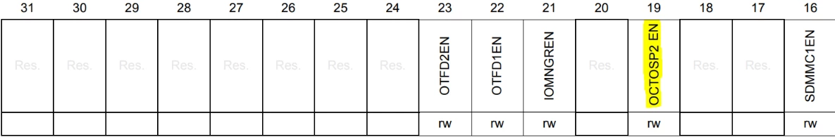

8.7.39 RCC AHB3 clock register (RCC_
AHB3ENR)
Expected:
Dec 2024

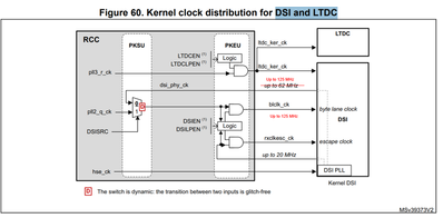

Figure 60. Kernel clock distribution for DSI and LTDC
Expected:
Mar 2026

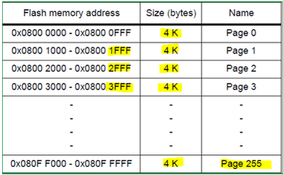

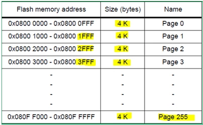

Table 9. Flash module - 1 Mbyte single-bank organization, DB1M = 0
(128 bits read width)
Expected:
Sep 2024

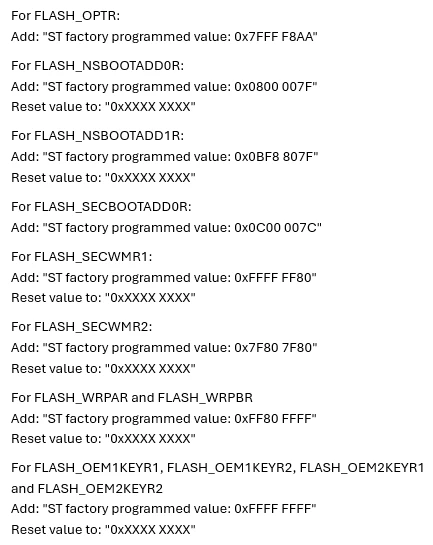

STM32WBA5
RM0493 Rev7
(Mar 2025)
7.9 FLASH registers
Expected:
Mar 2026

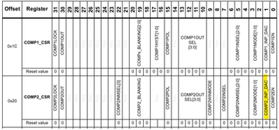

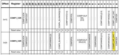

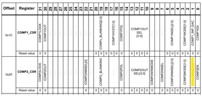

Table 109. COMP register map and reset values
Current:
Expected:
Mar 2026

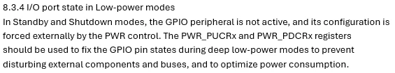

GPIO
STM32L47x/ 48x/49x/4Ax
RM0351 Rev10
(Oct 2023)
8.4 GPIO functional description
Add:
Oct 2024

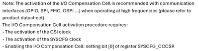

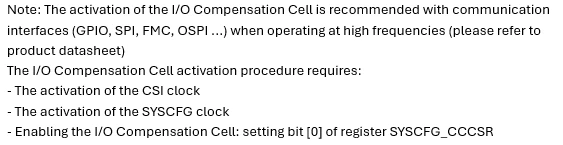

STM32H723/
733/725/735/730
RM0468 Rev3
(Dec 2021)
11.3.11 I/O compensation cell
Add:
Mar 2025

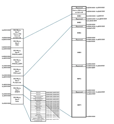

Figure 2. Memory map
Expected:
Mar 2026

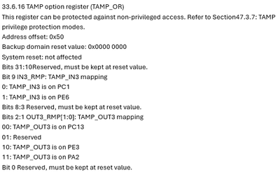

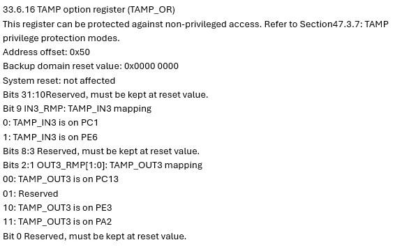

TAMP
STM32H503
RM0492 Rev3
(Nov 2024)
33.6.16 TAMP option register (TAMP_OR)
Add section:
Mar 2025

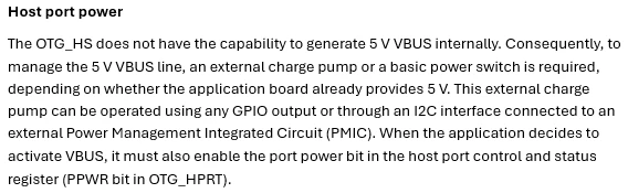

USB
STM32H745/ 755/747/757
RM0399 Rev4
(Jun 2023)
60.7.2 USB host states
Expected:
Sep 2025

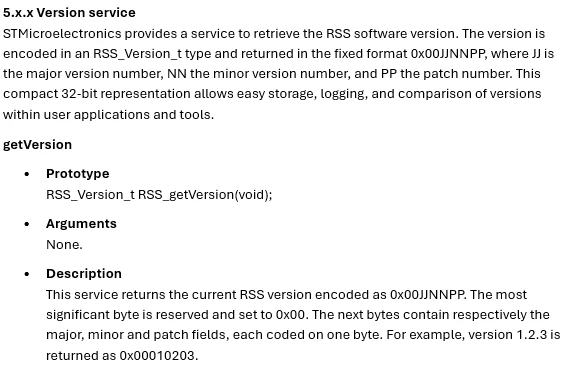

SMM
STM32H723/733/
725/735/730
RM0468 Rev3
(Dec 2021)
5.4 Root secure services (RSS)
Add:
The root secure services (RSS) are STMicroelectronics ROM code stored on the device.
They are part of the security features. These firmware services are available in Secure
access mode
Table xx gives the addresses of the application programming interface (API) described in
the following sections.
Sep 2025

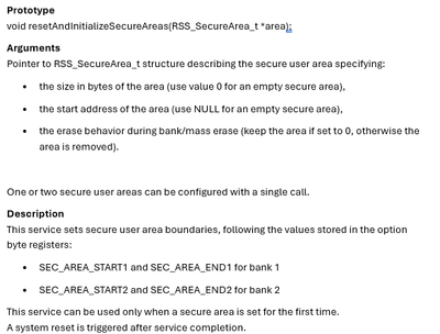

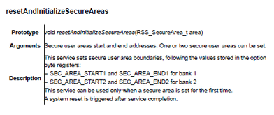

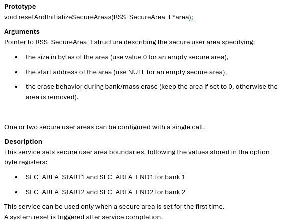

RM0399 Rev4
(Jun 2023)
STM32H742/
743/753/750
RM0433 Rev8
(Jan 2023)
5.4.1 Secure area setting service
Add:
Mar 2026

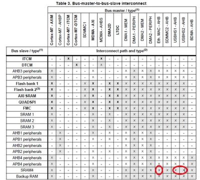

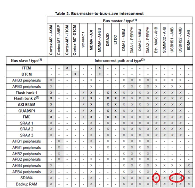

Memory and bus architec-ture
STM32H742/
743/753/750
RM0433 Rev8
(Jan 2023)
Table 3. Bus-master-to-bus-slave interconnect
Expected:
The 'x' from the circled boxes are removed
Dec 2025
