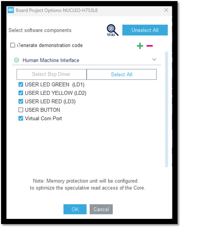

1.7.1 Project setup
- Create a new project in STM32CubeMX for your target board. I chose the NUCLEO-H7S3L8. Ensure the Boot and ExternalMemoryLoader contexts are included in the project.
Note: Untick "Generate demonstration code" for the Virtual Com Port when given the option.
- Enable USART3, ensuring the pins are PD8 and PD9 for UART debug output through the Virtual Com Port.
- Enable XSPI2 for external memory interface. Refer to the example above, however for the memory on the NUCLEO-H7S3L8, octo-SPI is supported, so update accordingly.
- Configure External Memory Manager (EMM), refer to the example above. However, the memory on NUCLEO-H7S3L8 can operate in quad-SPI or octo-SPI, so you can update the lines accordingly.
- Enable External Memory Loader. The loader name can be customized to your project.
- Generate code for your IDE; I chose STM32CubeIDE.
