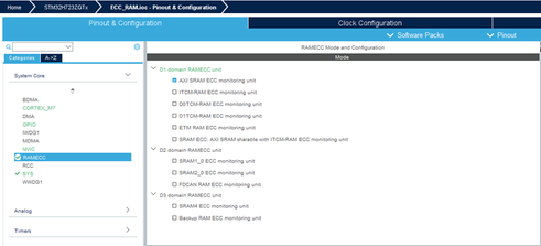

  • Create a new STM32H7 project using STM32CubeMX and enable the RAMECC monitoring of the memory you need to test.
  • In the .IOC file, go to [System Core] → [RAMECC]. Check the boxes next to each region of RAM you want to monitor. Here we’ll target the D1-AXI SRAM.

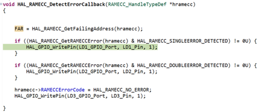

d. Add the following callback in main.c:
* @brief Single or double ECC error detected callback.
* hramecc : RAMECC handle
* @retval None
void HAL_RAMECC_DetectErrorCallback(RAMECC_HandleTypeDef *hramecc)
 FAR = HAL_RAMECC_GetFailingAddress(hramecc);
 if ((HAL_RAMECC_GetRAMECCError(hramecc) & HAL_RAMECC_SINGLEERROR_DETECTED) != 0U) {
 HAL_GPIO_WritePin(LD1_GPIO_Port, LD1_Pin, 1);
 if ((HAL_RAMECC_GetRAMECCError(hramecc) & HAL_RAMECC_DOUBLEERROR_DETECTED) != 0U) {
 HAL_GPIO_WritePin(LD2_GPIO_Port, LD2_Pin, 1);
 hramecc->RAMECCErrorCode = HAL_RAMECC_NO_ERROR;
 HAL_GPIO_WritePin(LD3_GPIO_Port, LD3_Pin, 1);

d. Run the test and set breakpoints into the callback to check if an ECC error occurred or not. You’ll be redirected to the callback function when ECC errors occurred as follows:

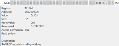

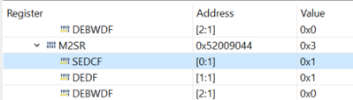

e. You can check the flags of the SR and the failing address registers (FAR) as well:

Hi, I tested this project on my Nucleo H723, I've noticed something weired.
The callbacks did occur, but with multiple time for the same FAR.
For example, FAR = 0x3C14 has two times single bit detection and FAR = 0X3C15 with two time double bit detection, ...etc. How to interpret this?
Moreover, I can't see the relationship between FAR and memory pointers.
Can you further explain the relationship between FAR and real physical memory address.
Thank you.
