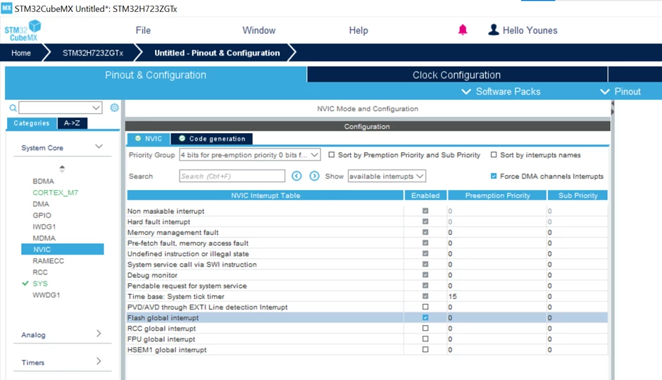

a. Create a new STM32H7 project using STM32CubeMX and enable the flash global interrupt line of NVIC.
b. In the .IOC file, go to [System Core] → [NVIC] and enable the flash global interrupt as follows:

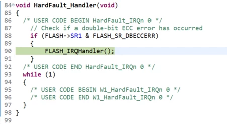

d. When a double bit ECC error occurs in flash, the HardFault handler is called instead of the flash IRQ handler. To get around this, add a check in the HardFault handler to see if a double bit error occurred in flash:
 * @brief This function handles Hard fault interrupt.
void HardFault_Handler(void)
 /* USER CODE BEGIN HardFault_IRQn 0 */
	// Check if a double-bit ECC error has occurred
	if (FLASH->SR1 & FLASH_SR_DBECCERR)
		FLASH_IRQHandler();
 /* USER CODE END HardFault_IRQn 0 */
 while (1)
 /* USER CODE BEGIN W1_HardFault_IRQn 0 */
 /* USER CODE END W1_HardFault_IRQn 0 */

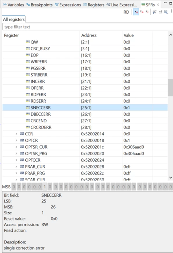

2. How to test the flash ECC SEDC single error detection-correction

e. Debug will trigger the single error correction callback. Set a breakpoint inside the single error callback function and you can see that an ECC single error interrupt happened:
The SNECCERR flag will also be set in the FLASH_SR register to indicate a single error detection correction.

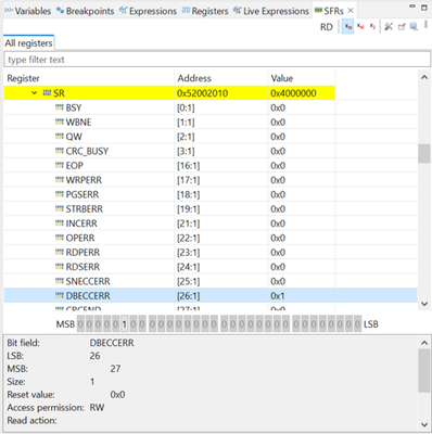

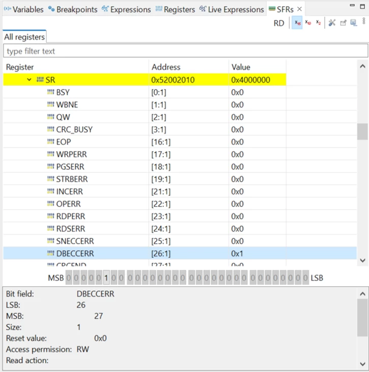

d. Debug triggers the Hardfault handler and the double error flag will be set in the FLASH_SR register to indicate a double error detection correction.

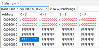

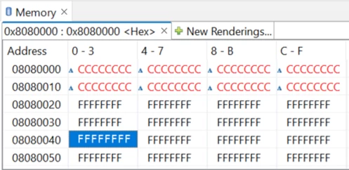

The first programming of DoubleErrorB is observed in the debug memory window below:
The second programming of the DoubleErrorA injects a double ECC error which will cause the hardfault.
The flag is also set in the FLASH_SR register as follows:

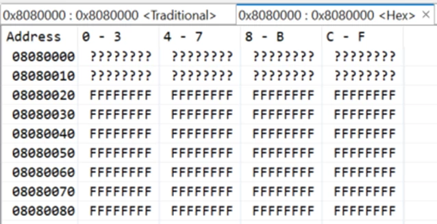

The debugger is not able to read the content of programmed 256-bit due to the double error detection. Corrupted data will be seen in the memory window at this address:

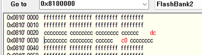

  1. Do you know why my data is changing from 0xCC t0 0xDC when I call the below function:
 if (HAL_FLASH_Program(FLASH_TYPEPROGRAM_FLASHWORD, DstAddr, ((uint32_t) SingleErrorA)) != HAL_OK)
   2.  Why would two consecutive programming operations trigger an ECC error ?
