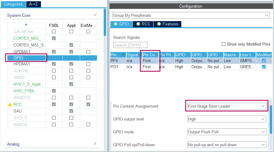

3.1 Configure the GPIO pins

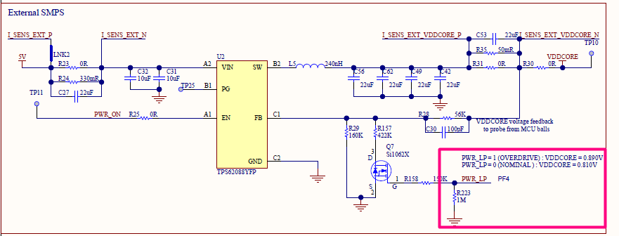

On STM32CubeMX, you need to turn on PF4 (usually turned off by default) to get the VDDCORE to 0.89 V (OVERDRIVE). This is shown in the Discovery kit schematic, on page 5.
Locate the PF4 and configure it as GPIO_Output and use the label to name it SMPS_OVD.
Also, locate the PO1 and configure it as GPIO_Output and use the label to name it GREEN_LED.
We need to assign both GPIOs to be used by the FSBL.

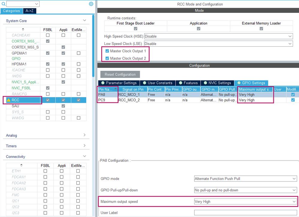

3.2 Configure the RCC and ICACHE

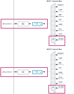

The next step is to configure the RCC by enabling the MCO1 and MCO2 (automatically assigned to PA8 and PC9, respectively). By reproducing this step, we can later confirm the desired frequency output value using an oscilloscope.

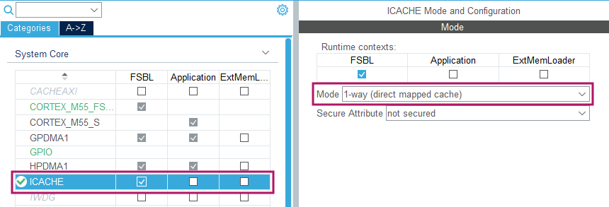

Back to the “Pinout & Configuration” tab, you need to turn on the ICACHE feature to make the most out of the overdrive mode.

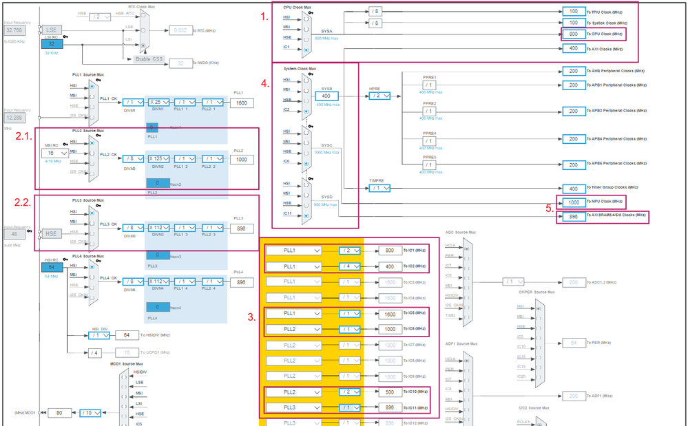

3.3 Clock configuration
Since we already set the VDDCORE to 0.89 V, the next step shows the correct clock tree configuration to have the maximum frequency output on the CPU, NPU, and AXISRAM3/4/5/6.
In STM32CubeMX’s “Clock Configuration” tab, follow according to the image below:

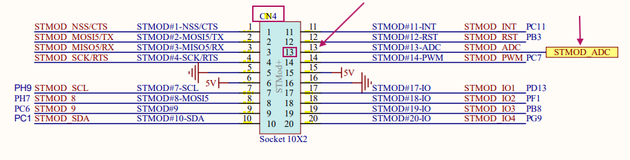

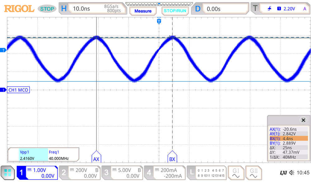

To see your application running, you can use the MCO2 pin configured before. This pin can be found in the CN4 socket, as shown in the Discovery kit schematic (page 10), or at the TP2 and TP3 test points.
Note: During the “STM32CubeMX Configuration” portion of this article, we configured the MCO2 frequency with a /10 divider. This modification allows us to measure the CPU frequency with most scopes precisely.
The final wave should be something like the following:

is it correct that on the NUCLEO board of the same MCU you'd have to use the internal SMPS through the ACTVOS bit of the PWR_VOSC register instead of the BF4 GPIO config to select the overdrive power mode? Are there any other substantial differences I should know of before trying to apply this strategy to the NUCLEO version?
Kind regards,
Lennart Heske
Engineering student and hobbyist
Have you managed to get overdrive to work with Nucleo? How did you achieve it?
In Nucleo Board schematic its not noted that the PWR_LP is tied to any pin ?
Nucelo board external SMPS
