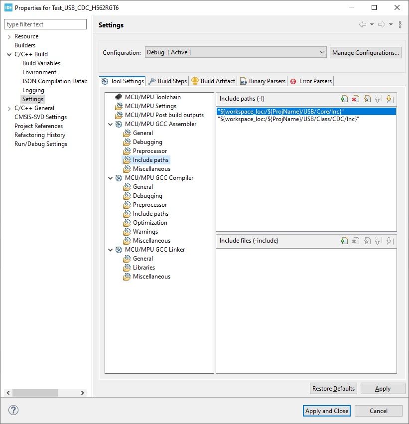

Add the path to the include reference. Right click in the ‘Inc’ folder inside the USB/Class/CDC/.. path, then select `Add/remove include path…` option, and in the pop-up menu, press OK. Perform the same steps for the USB/Core/Inc as well.

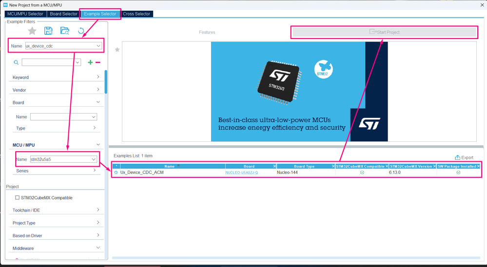

Is there an example of how this could be done on a stm32U5A5 in ThreadX/USBX?
D.Botelho
Hello @DavidRi,
Yes, please refer to de demos in the link below:
STM32CubeU5/Projects/NUCLEO-U5A5ZJ-Q/Applications/USBX at main · STMicroelectronics/STM32CubeU5 · GitHub

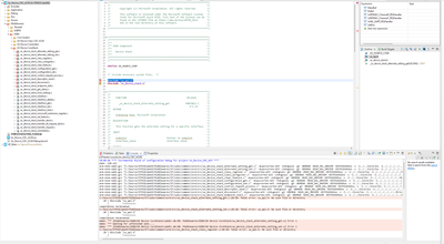

DavidRi
This is the result what is wrong?
Regards
David.
D.Botelho
Hello @DavidRi,
Let's try importing in a different way. When creating a new project in the STM32CubeIDE, in the MCU selector, navigate to the Example Selector menu, search for the demo and MCU, and finally start the project. It will import the files in the right way, avoiding compilation issues.
Hope it helps!
Best Regards,
Dan

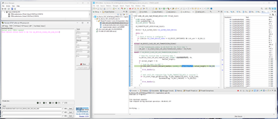

DavidRi
Thanks Dan that building and running now.  However it does not transmit back my receive buffer, when sent back from beyond the breakpoint indicated below...
Regards
David.
D.Botelho
Hello @DavidRi ,
The purpose of this demo is to act as a UART to USB bridge. So, the data you send through UART will appear in the USB VCom, and the data sent through VCom will appear in the USB. The used UART is connected to the ST-LINK VCom port. Therefore, this demo will use the two VCOM Ports available in your board. The first one is the ST-LINK VCOM Port, and the second one is your USB CDC ACM Application.
To see the complete demo working, you should open two VCom terminals, one for the ST-LINK and the other for the USB CDC ACM. Then, when you send a data through a terminal, this data should be echoed in the second terminal.
Best Regards,
Dan

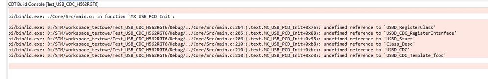

Hello everyone,
I'm trying to run the example from this thread, but I'm getting the errors shown in the attachment. I've added the paths to the Inc folders. The processor is H562RGT6, Cube v1.18.1, Repository v1.5.0. What am I doing wrong?error.jpgpaths.jpg
