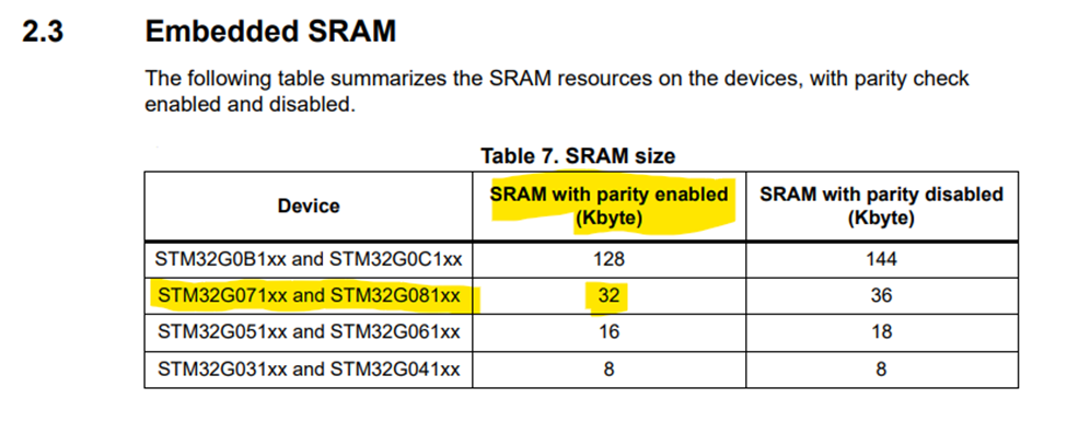

2. Ensure Linker File Reflects Potential SRAM Size Changes
On some MCUs, enabling parity for the SRAM will change the size of the SRAM. This is the case for the example MCU used in this article: the STM32G071RB.
In the reference manual for the part, in the section regarding the embedded SRAM, it shows a table outlining how parity affects the size of SRAM. We need to ensure that the size of SRAM is defined correctly in the linker file. If it is not, the linker file will assign the stack to the end of SRAM assuming it is 36kB, but since it is 32kB now the stack will be assigned to a non-valid address. This will cause a hard fault. In the linker file STM32G071RBTX_FLASH.ld, change the size of the RAM to reflect enabled parity:
/* Memories definition */
MEMORY
	/* Commented out old memory defintion of 36kB */
 /* RAM (xrw) : ORIGIN = 0x20000000, LENGTH = 36K */
 /* Parity changes SRAM size to 32kB */
 RAM (xrw) : ORIGIN = 0x20000000, LENGTH = 32K
 FLASH (rx) : ORIGIN = 0x8000000, LENGTH = 128K
If you are experiencing a hardfault when enabling parity for SRAM, this could likely be the issue. Be sure to check in the reference manual for your MCU whether parity changes the size of the SRAM or not.
