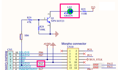

In this demonstration, we use the STLINK VCOM Port connected to the MCU's USART3 (figure 2). Furthermore, we use the TIM2 and the board’s user LED (figure 3). Two callbacks are registered: one for the UART_Tx and the other one for the timer overflow, also known as period elapsed interrupt. By the end of this article, you should have the necessary knowledge to do your own Register callback implementations in any kind of application. So, grab your coffee, settle into your chair, and let us start coding!

Figure 3 – User’s LED ConnectionFigure 3 – User’s LED Connection
Source: Adapted from https://www.st.com/content/ccc/resource/technical/layouts_and_diagrams/schematic_pack/group2/94/07/0d/de/30/11/4c/3b/mb-1814-h503rb-b02-schematic/files/mb1814-h503rb-b02-schematic.pdf/jcr:content/translations/en.mb1814-h503rb-b02-schematic.pdf

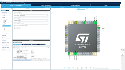

Create a project for the STM32H503RB using the STM32CubeIDE. In this project, the following settings are applied:
  • USART3: 115200 bits/s - 8N1:
    • PA3 as UART_RX.
    • PA4 as UART_TX.
  • PA5 as GPIO Output with USER_LED label.
  • TIM2 as 1 second time base:
    • Internal clock as source.
    • Prescaler as 24999
    • Counter period as 9999
    • Autoreload preload enabled.
  • NVIC: Enable both USART3’s and TIM2’s ISRs.
Figure 4 – MCU Project Settings. Source: Author’s screenshot.Figure 4 – MCU Project Settings. Source: Author’s screenshot.

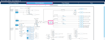

The next changes are made at the clock configuration tab. In this tab, the HCLK frequency needs to be changed to 250 MHz (this frequency matches the TIM2 settings for the 1 second time base).
Figure 5 – Clock configuration settings. Source: Author’s screenshot.Figure 5 – Clock configuration settings. Source: Author’s screenshot.
