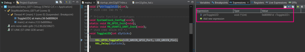

Let’s start by creating the function pointer. Be cautious, as it needs to match the return type and the passing arguments with the function you want to point to. For the proposed example, the ToggleLED function doesn’t return anything and expects an integer as an argument for the delay in ms. In this case, the pointer declaration that should be used is as follows:
/* USER CODE BEGIN PV */
void (*ptrToggleLED)(int);
/* USER CODE END PV */
The pointer called ptrToggleLED is now created and it can be used to point to our function, but before that, the function needs to be created as well:

Afterwards, the respective function address needs to be assigned to the pointer, this can be easily accomplished by assigning the function to the pointer.
/* USER CODE BEGIN 2 */
ptrToggleLED = ToggleLED;
/* USER CODE END 2 */
Finally, you can use the pointer as a function as if this was the function itself in the main loop.
/* USER CODE BEGIN WHILE */
while(1)
      ptrToggleLED(250);
At this point, you can build and program the board. The LED should be blinking normally at the 250ms ratio. If you want to explore more, you can even debug and check that the pointer worked. Place a breakpoint inside the original function and check the pointer in the [Expressions] tab.

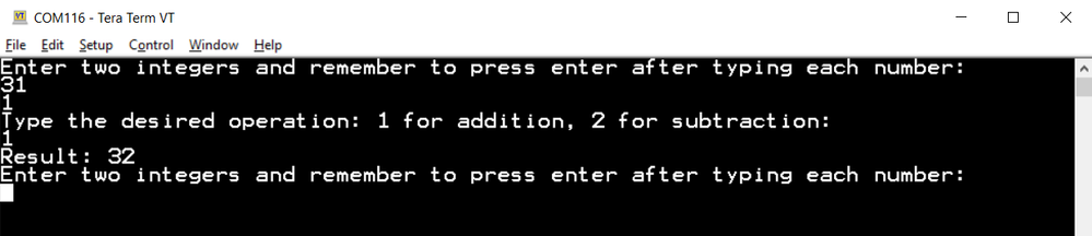

1.3. Basic example 2
This example's goal is to change the function called based on the user’s input on the terminal. This application requires the UART usage and to facilitate the code flow, the printf, and scanf functions are used. The default UART settings should be [115200], [8 bits], [No Parity], [1 Stop bit], but this can be changed in the *.ioc file or directly in the MX_USART2_UART_Init function.
Add these code snippets:

2.  Example 2 results
Press [Ctrl + B] to build the project; there should be no errors or warnings. Program the board and open your preferred terminal. In this case, we use Tera Term with the 115200, 8, N, 1 setting. Running the code, we can play with the simple example by adding or subtracting:
