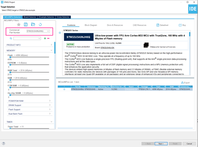

2. STM32CubeMX settings and configurations

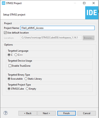

Let us start by creating a new STM32 project following the steps in the image.
After these steps, you will be directed to the "Target Selection" tab. Insert the part number STM32U5A9NJH6Q in the Search Box as shown in the image below.
Click on next and name your project. Click on finish to open the ioc file.

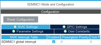

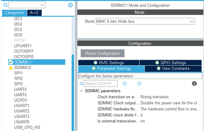

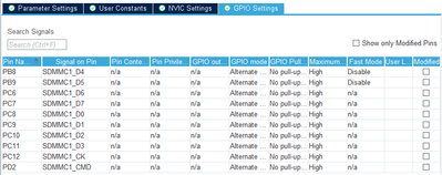

2.2 SDMMC1 configuration
Enable the peripheral by selecting Mode "MMC 8 bits Wide bus" with the parameter settings remaining as default.
In addition, we need to configure the NVIC settings to select the SDMMC1 global interrupt as the code uses a few callbacks based on the ISR. These callbacks are responsible for managing the transmission and reception flags of messages between the eMMC and the MCU.
To ensure correct eMMC pinout connections were assigned, navigate to the GPIO Settings and refer to the table below for comparison.

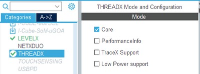

2.3 ThreadX configuration
As mentioned, this example uses the RTOS, but a similar approach could be done in bare metal mode. Navigate to the "Middleware and Software Packs" section and locate ThreadX. To enable it, navigate to the Mode selection, click on the "Core" box, and keep the configuration as default.

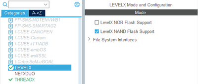

2.4 LevelX configuration
LevelX is a powerful library that provides wear-leveling and bad-block management features for flash memories. While it does not offer file system APIs, it does provide low-level APIs for reading, writing, and erasing sectors in flash memories. When combined with FileX, it enables seamless use of NAND and NOR flash memories as media storage devices.
To enable it, locate LEVELX as shown in the image above. Click on the "LevelX NAND Flash Support" box, all other configurations remain as their default settings.

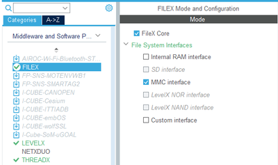

2.5 FileX configuration
To activate the FileX library, simply select the "FileX Core" checkbox and choose the "MMC interface" option in File System interfaces. The configurations can remain at their default settings.
All set, you can save and generate the code!

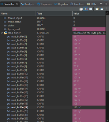

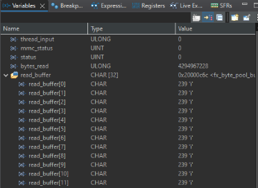

4. Debug and results
The debug logic for this application includes LED functionality and variable monitoring. The green LED blinks to indicate the system's good functioning, while the red LED is set to a high level and shines continuously when an error occurs.
Additionally, the STM32CubeIDE debug perspective provides a "Variables" tab that displays every declared variable. This enables easy monitoring of the read_buffer behavior and providing valuable insight into the system's performance.
At the start of the application, the read_buffer is initialized with default values in all of its positions, as shown in the image below.
After initializing the data variable with the string "This is FileX working on STM32" and subsequently writing its contents to the designated file, the values stored in the read_buffer are altered as a result of this operation. Please refer to the image below for verification.
