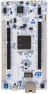

Figure 1 – STM32 Nucleo-H753ZIFigure 1 – STM32 Nucleo-H753ZI

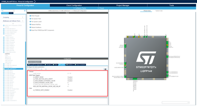

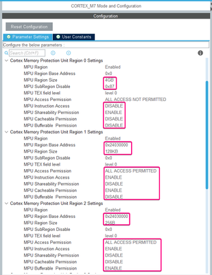

One of the key aspects is properly configuring the MPU on the CORTEX_M7. Enable both CPU caches, speculation default mode and set the MPU control mode as background region privileged access only + MPU disabled during hard fault, NMI, and FAUTMASK handlers. More details about the settings and addresses are covered in this article: https://community.st.com/t5/stm32-mcus/how-to-create-project-for-stm32h7-with-ethernet-and-lwip-stack/ta-p/49308
MPU regions must be configured to specify the access to both Ethernet descriptors, such as in the picture below.
Figure 2 – MPU configurationFigure 2 – MPU configuration

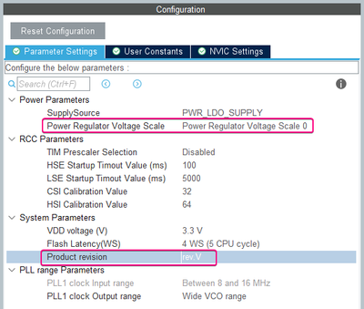

To allow for optimal performance the microcontroller should run at its highest frequency. As stated in the errata sheet ES0392 revisions Y or W of the H753 family are limited to run at 400 MHz and does not require this step. However, if revision X or V is being used, the RCC tab must be configured.
Figure 3 – RCC configurationFigure 3 – RCC configuration
Setting the product revision to V allows the user to configure the power regulator voltage scale to 0, which enables the microcontroller to reach its highest possible frequency.

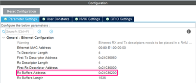

1.1.1 Connectivity tab setup
In the connectivity tab, both the Ethernet and USART3 peripherals are used. Ethernet is the focus of this application, and the serial port is used for debug purposes, such as application flow and IP address handling.
RMII Ethernet mode must be enabled. Configure the Rx buffers length to the maximum value and the first descriptor addresses must be set as such:
Figure 5 – Ethernet configurationFigure 5 – Ethernet configuration
Lastly in the Ethernet tab, navigate to the NVIC settings tab and check the Ethernet global interrupt enable box.
Figure 6 – Ethernet NVIC configurationFigure 6 – Ethernet NVIC configuration

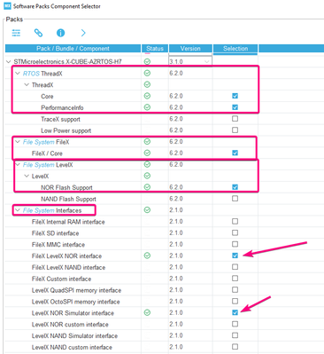

1.1.2 Middleware and software packs tab setup

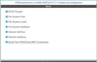

In this tab, "MIDDLEWARES" is selected. Look for the X-CUBE-AZRTOS-H7 and download its latest version if it is greyed out. Once it is installed click it to open the software packs component selector pop-up.
Now, select the following middleware to configure the operational system ThreadX, the file system FileX and its subsystem LevelX. Doing so, we can simulate a NOR interface inside the microcontroller’s memory:
Figure 8 – Software Packs ecosystem configurationFigure 8 – Software Packs ecosystem configuration

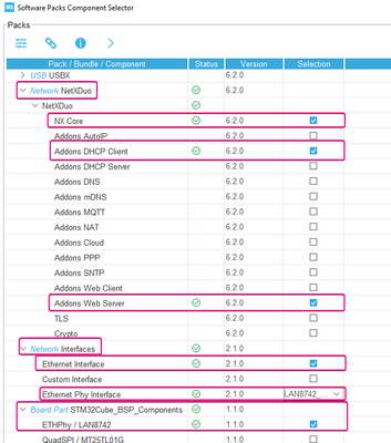

Next, the network middleware and interface must be configured. NetXDuo has its core and both DHCP client and web server addons enabled. The network interfaces and BSP PHY must be configured respecting the parts present in the Nucleo board.
Figure 9 – Software Packs network configurationFigure 9 – Software Packs network configuration
After selecting all the necessary components, press ok and the pop-up will be closed to present a few checkboxes. All of them must be checked so that the middleware is included in the project files.
Figure 10 – Middleware selection tabFigure 10 – Middleware selection tab

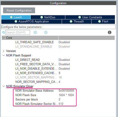

1.1.2.1 LevelX Configuration
LevelX is used in this application to simulate a NOR driver in the microcontroller’s internal memory.
Figure 11 – LevelX ConfigurationFigure 11 – LevelX Configuration
We must configure the base address of the simulated NOR driver to 0x08100000, its size to 1 MB and sectors to two, as the picture shows. The html files are stored at this address.

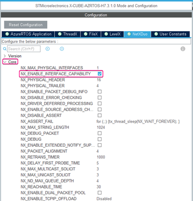

1.1.2.2 NetXDuo Configuration
This middleware is the heart of the application, managing the webserver and all its required protocols under the OSI model. Starting with the core, NX_ENABLE_INTERFACE_CAPABILITY must be checked.
Figure 12 – NetXDuo configurationFigure 12 – NetXDuo configuration

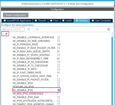

On the IP subsection, the NX_DISABLE_IPV6 checkbox must be ticked and the other parameters as default
Figure 13 – IP configurationFigure 13 – IP configuration
All other NetXDuo tabs should be kept at their default settings.

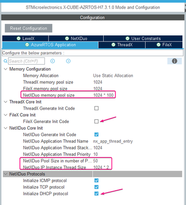

1.1.2.3 AzureRTOS Application Configuration

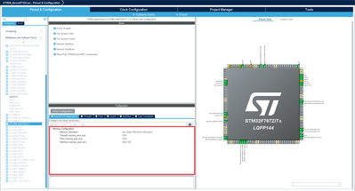

This tab configures the memory allocation and initialization of all related stacks and middlewares.
The NetXDuo memory pool size must be multiplied by 100. "FileX Generate Init Code" box must be unchecked. NetXDuo pool size in number of packets must be set to 50 instead of 5. The IP instance thread size multiplied by 2. The last configuration is to check the "Initialize DHCP protocol."
Figure 14 – Pool size configurationFigure 14 – Pool size configuration

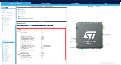

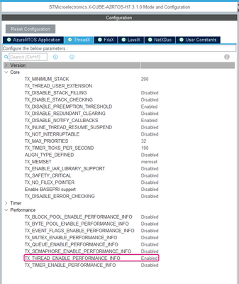

Here is where the kernel is configured. The only difference from default settings is that the TX_THREAD_ENABLE_PERFORMANCE_INFO parameter must be enabled.
Figure 15 – ThreadX configurationFigure 15 – ThreadX configuration

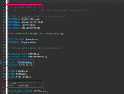

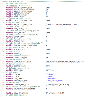

Afterwards, private variables must be created to set data structures essential for ThreadX, NetXDuo byte pools, and the FileX data structures.
/* Define Threadx global data structures. */
TX_THREAD AppServerThread;
TX_THREAD LedThread;
TX_THREAD AppLinkThread;
/* Led toggling thread entry */
void LedThread_Entry(ULONG thread_input);
/* Define NetX global data structures. */
NX_PACKET_POOL WebServerPool;
ULONG IpAddress;
ULONG NetMask;
ULONG free_bytes;
NX_WEB_HTTP_SERVER HTTPServer;
/* Set nx_server_pool start address */
#if defined ( __ICCARM__ ) /* IAR Compiler */
#pragma location = ".NxServerPoolSection"
#elif defined ( __CC_ARM ) || defined(__ARMCC_VERSION) /* ARM Compiler 5/6 */
__attribute__((section(".NxServerPoolSection")))
#elif defined ( __GNUC__ ) /* GNU Compiler */
#endif
static uint8_t nx_server_pool[SERVER_POOL_SIZE];
/* Define FileX global data structures. */
/* the server reads the content from the uSD, a FX_MEDIA instance is required */
FX_MEDIA Flash_Media;
/* Buffer for FileX FX_MEDIA sector cache. this should be 32-Bytes aligned to avoid
 cache maintenance issues */
ALIGN_32BYTES (uint32_t DataBuffer[512]);

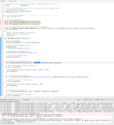

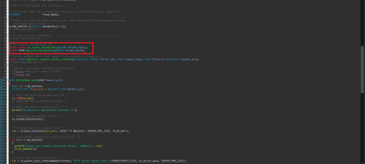

The next portion of code to be modified is USER CODE BEGIN MX_NetXDuo_Init
printf("Nx_Webserver application started..\n");
/* Initialize the NetXDuo system. */
nx_system_initialize();
/* Allocate the server packet pool. */
ret = tx_byte_allocate(byte_pool, (VOID **) &pointer, SERVER_POOL_SIZE, TX_NO_WAIT);
/* Check server packet pool memory allocation. */
if (ret != NX_SUCCESS)
	printf("Packet pool memory allocation failed : 0x%02x\n", ret);
	Error_Handler();
/* Create the server packet pool. */
ret = nx_packet_pool_create(&WebServerPool, "HTTP Server Packet Pool", SERVER_PACKET_SIZE, nx_server_pool, SERVER_POOL_SIZE);
/* Check for server pool creation status. */
	printf("Server pool creation failed : 0x%02x\n", ret);
	Error_Handler();
/* Allocate the server stack. */
ret = tx_byte_allocate(byte_pool, (VOID **) &pointer, SERVER_STACK, TX_NO_WAIT);
/* Check server stack memory allocation. */
	printf("Server stack memory allocation failed : 0x%02x\n", ret);
	Error_Handler();

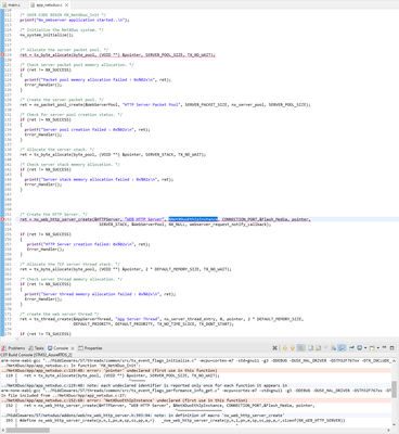

Here some memory handling takes place: Server packet pool and server stack are allocated, and their allocation is checked. If it fails, a debug message is displayed and the error handler function called. Most threads and functions from now on will have this error checking functionality.
The next step is to allocate memory and create threads for all services going to be used. HTTP server, web server thread, a thread to blink the LED, and a link thread are all created in this portion, also memory allocation for all these services and the TCP server thread.
/* Create the HTTP Server. */
ret = nx_web_http_server_create(&HTTPServer, "WEB HTTP Server", &NetXDuoEthIpInstance, CONNECTION_PORT,&Flash_Media, pointer,
 SERVER_STACK, &WebServerPool, NX_NULL, webserver_request_notify_callback);
 printf("HTTP Server creation failed: 0x%02x\n", ret);
 Error_Handler();

1.2.5 app_netxduo.h
In this header file a few definitions must be added. Mostly setting thread priorities, a small IPv4 printing macro, and some memory pool size configurations.
/* USER CODE BEGIN EM */
#define PRINT_IP_ADDRESS(addr) do { \
 printf("%s: %lu.%lu.%lu.%lu \n", #addr, \
 (addr >> 24) & 0xff, \
 (addr >> 16) & 0xff, \
 (addr >> & 0xff, \
 addr& 0xff);\
 }while(0)
/* USER CODE END EM */
/* USER CODE BEGIN EFP */
#define NX_APP_INSTANCE_PRIORITY 5
/* USER CODE END EFP */
/* USER CODE BEGIN PD */
/* Pirority IP creation */
#define DEFAULT_MEMORY_SIZE 1024
#define DEFAULT_MAIN_PRIORITY 10
#define TOGGLE_LED_PRIORITY 15
#define DEFAULT_PRIORITY 5
#define LINK_PRIORITY 11
 /*Packet payload size */
#define PACKET_PAYLOAD_SIZE 1536
/* Packet pool size */
#define NX_PACKET_POOL_SIZE ((1536 + sizeof(NX_PACKET)) * 50)
 /* APP Cache size */
#define ARP_CACHE_SIZE 1024
 /* Wait option for getting @IP */
#define WAIT_OPTION 1000
/* Entry input for Main thread */
#define ENTRY_INPUT 0
/* Main Thread priority */
#define THREAD_PRIO 4
/* Main Thread preemption threshold */
#define THREAD_PREEMPT_THRESHOLD 4
/* Web application size */
#define WEB_APP_SIZE 2048
/* Memory size */
#define MEMORY_SIZE 2048
/* HTTP connection port */
#define CONNECTION_PORT 80
/* Server packet size */
#define SERVER_PACKET_SIZE (NX_WEB_HTTP_SERVER_MIN_PACKET_SIZE * 2)
/* Server stack */
#define SERVER_STACK 4096
/* Server pool size */
#define SERVER_POOL_SIZE (SERVER_PACKET_SIZE * 4)
/* SD Driver information pointer */
#define SD_DRIVER_INFO_POINTER 0
#define NULL_IP_ADDRESS IP_ADDRESS(0,0,0,0)
#define NX_APP_CABLE_CONNECTION_CHECK_PERIOD (6 * NX_IP_PERIODIC_RATE)
/* USER CODE END PD */

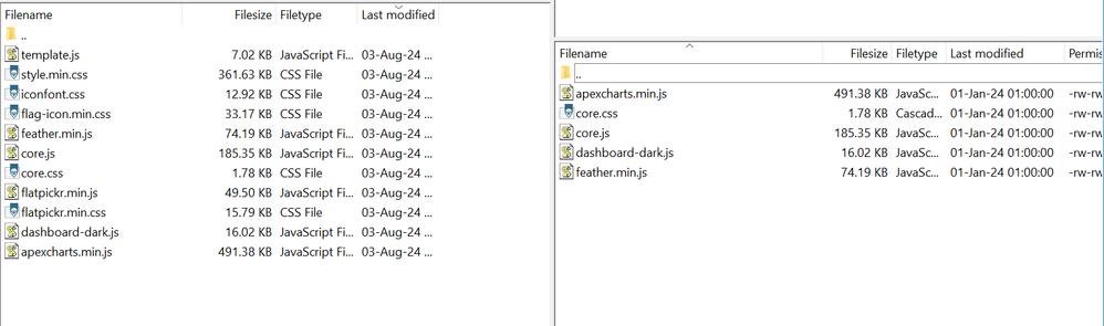

Graduate
August 5, 2024
Dear @Lucas_Costa,
I tested your FxImageCreator, I finally got it to work in my use case, however it only works partially (there are only around half of the expected files in the output binary)
A simple description of my program and use case: I have a custom board (minimalistic STM32H743VIH board with basically only USB FS. There is an USB-X Device RNDIS and NetX HTTP server. On top of it, there is a FTP server. I only need a read-only FileX filesystem to hold the website assets so I decided to go for a sideloaded binary and using the LevelX NOR Simulator with pointer to 0x08060000.
This works, it mounts the filesystem prepared by your tool properly, I can even check via Filezilla FTP client. However my "resources" folder which contains some javascripts and CSS style files does not unfortunately contain all the files. Your tool showed no error (see the output).
I triple checked, there should be enough space in the 1664kB (1703936 Bytes) filesystem (total included files size = 1383902 Bytes)
Is it not enough space for the output binary? Or other issue / bug in the FileX binary builder tool?
Can you please try yourself?
This is the output:
..\FxImageCreator.exe -S 1703936 -s 1024 -b 2048-r . -o ..\output.bin
===============> Configuration <===============
Image Size :1703936
FileX Sector Size :1024
Physical block size :2048
Root directory :.
Output file :..\output.bin
Bin image ' ..\output.bin' ready!
See the picture - left panel shows expected files, right panel is the actual STM32's sideloaded binary content
Ad.: FileX sideloaded binary prepared using DOS FAT12/FAT16 (formatted in Windows 10, using a virtual ImDisk drive mounted to a .bin file) does not work at all - FileX can't read such a filesystem. It might be by design, but it is a bit unfortunate given the fact the old FatFS implementation could read these Filesystems just fine
Looking forward to hear any helpful advice.
