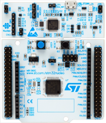

  • Micro USB cable used to power the Nucleo board from a host machine and to load the code into the STM32.

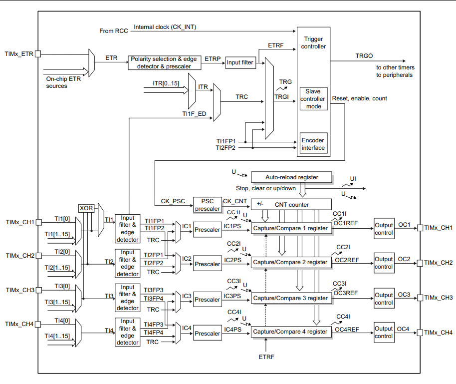

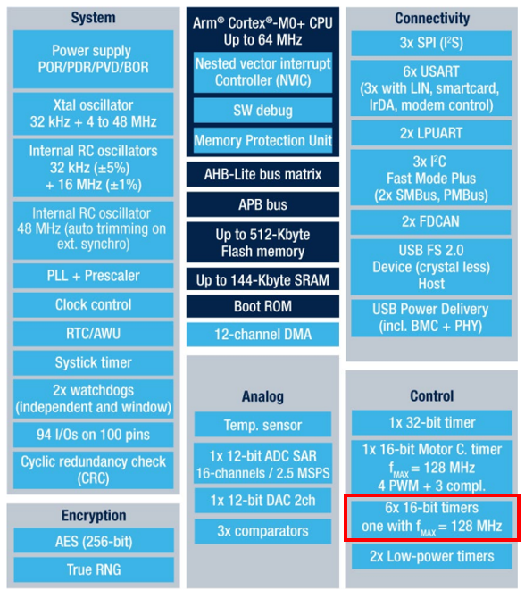

In this article, a general-purpose STM32 timer is used to generate an interrupt every second. The SysTick timer or the real-time clock (RTC) could be used for this purpose. However, this article uses a simple timer, TIM3, in an STM32G0 microcontroller. TIM3 is one of several timers embedded in STM32 microcontrollers.
TIM3 contains many components as shown in the following block diagram. While the timer supports a number of functions and features, only a subset is needed to generate a periodic one second interrupt. The following components of the timer block are used and configured for this example:
  • Input clock (clock source for the timer): This clock, called Internal clock (CK_INT), comes from the RCC (Reset and Clock Control) block and is prescaled from the peripheral clock (APB) which is prescaled from the AHB clock.
  • Prescaler input clock, CK_PSC, comes from the Trigger controller and is the same as the input clock
  • PSC prescaler divides its input clock, CK_PSC, and outputs it as CK_CNT
  • CK_CNT is the input clock to the CNT counter that is used to increment it
  • Auto-reload register (ARR) is loaded with the value that the counter increments to. When the value is reached, an update interrupt is generated, the counter is cleared and restarts counting again. The value loaded into the ARR determines the periodic rate of the timer interrupts.

When the counter value reaches the auto-reload register value, the TIM update interrupt is generated. In the handler routine, pin PA5 (connected to LED4 on the Nucleo board NUCLEO-G070RB) toggles.

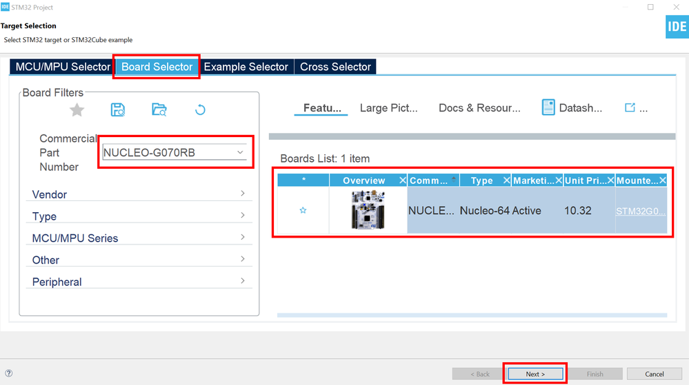

  2. Create a new project using the NUCLEO-G070RB board

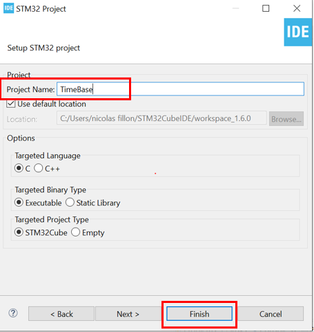

  1. Give a name to the project

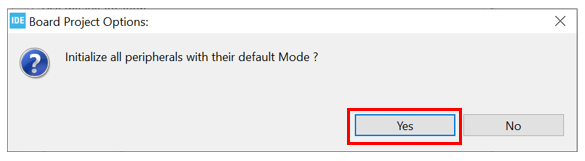

  1. Initialize all peripherals with their default settings

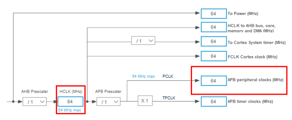

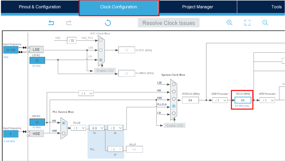

  1. Set the System Clock frequency
We are going to set HCLK to the maximum of 64 MHz.
Setting the APB Presecaler to 1 results in the APB Peripheral Clock (PCLK) set to 64 MHz also.

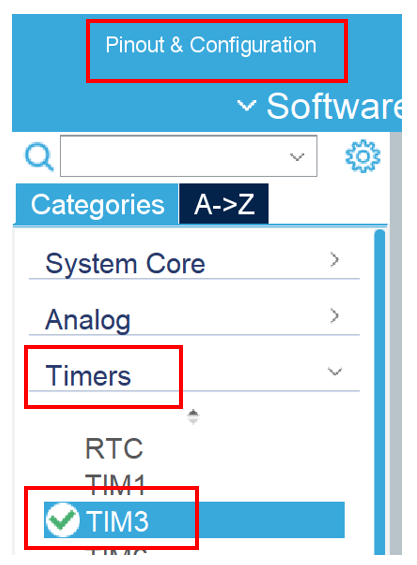

  1. Select TIM3
Note that while you can use any timer, TIM3 is used in this example.
You will find TIM3 in the Pinout & Configuration Tab of the STM32CubeIDE under “Timers”.

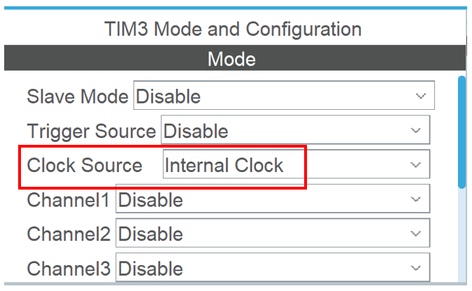

  1. Select internal clock as clock source for TIM3:
In the TIM3 Mode and Configuration, select Internal Clock as Clock Source.

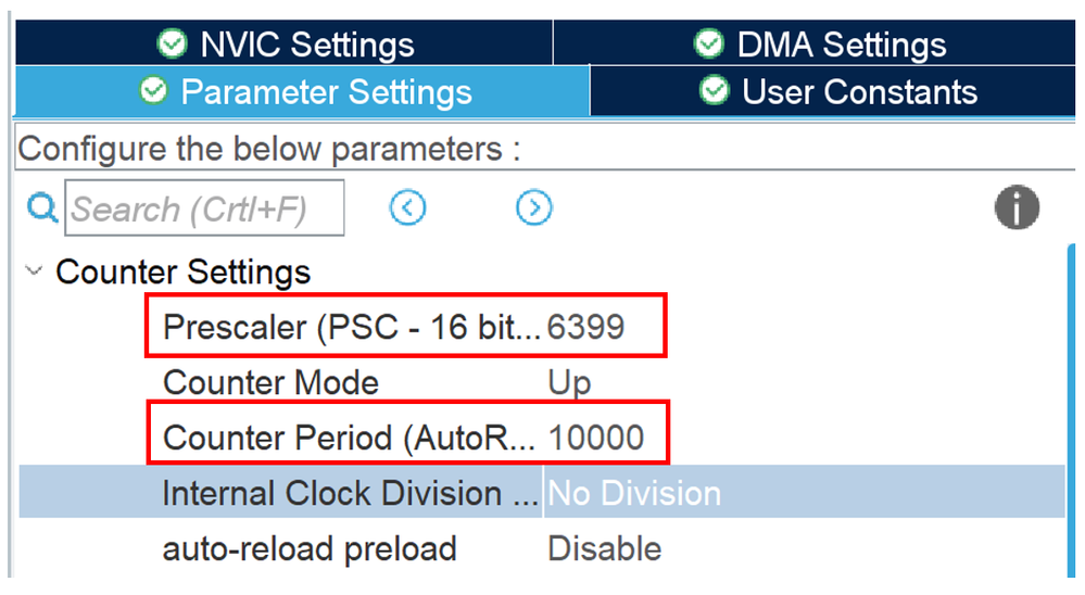

  1. Configure TIM3
In the Parameter Settings section, input the values calculated in the theory section.
Set the prescaler to 6399.
Set the counter period to 9999.
Alternatively, use the expression form 6400 - 1 for the prescaler and 10000 - 1 for the counter period. The figure below shows both options.

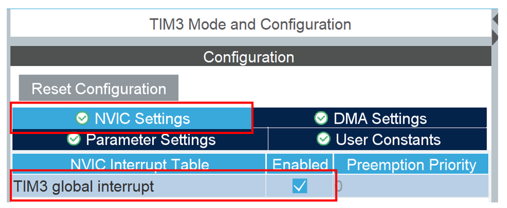

  1. Enable TIM3 global interrupts

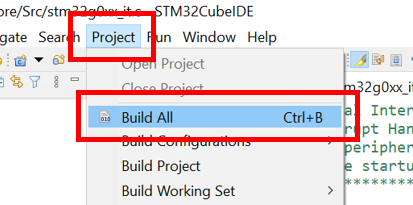

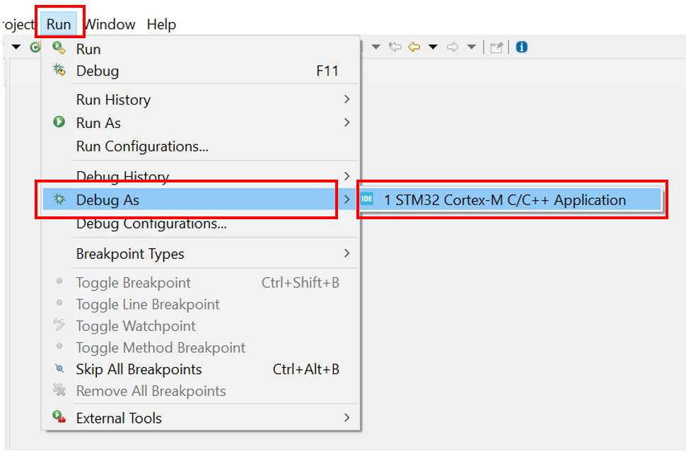

  1. Build the project, enter debug mode and run the code
After the project is built, enter a debug session and then click on the Resume icon to run the code.
While the code is running, the green LED is toggled every second as configured.
