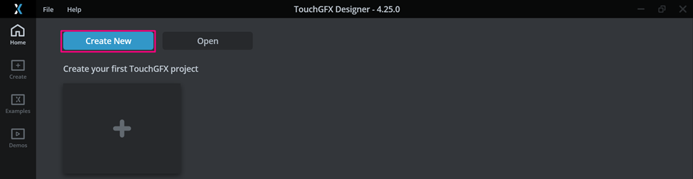

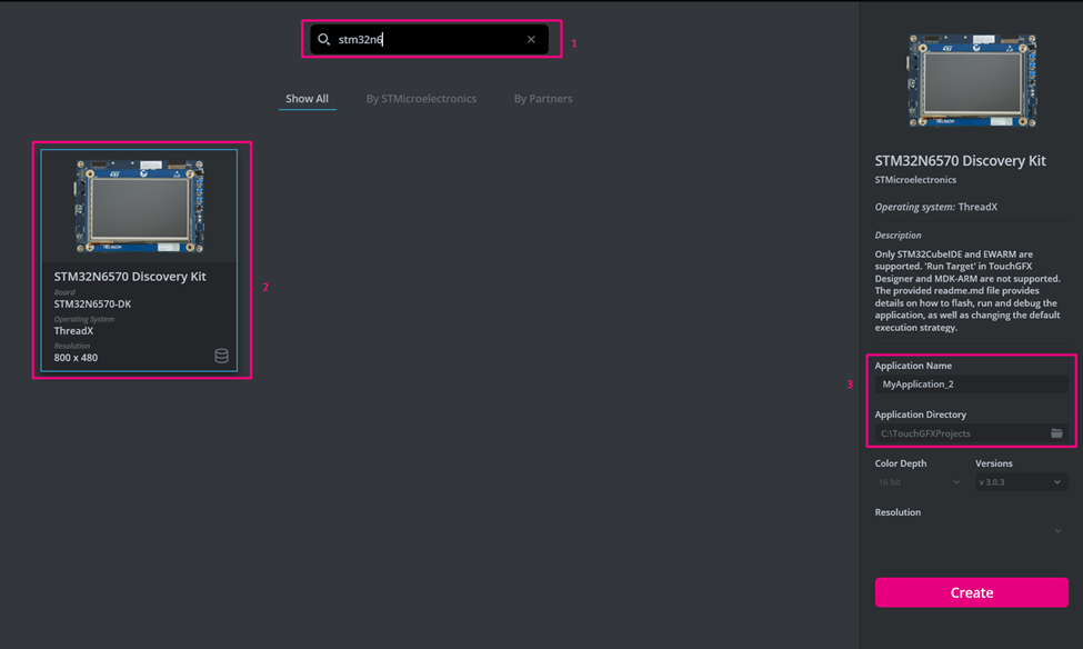

1. Create a simple project using TouchGFX by clicking [Create New].BMontanari_1-1759933704366.png
2. Select the board by filtering with "STM32N6," then click on the board and configure the path and project name.BMontanari_2-1759933739210.png3. Configure the application as desired. For this example, the Flex Button demo code application is used.FlexButtonN6_Gif1.gif4. Once the design includes all desired features, generate the project.

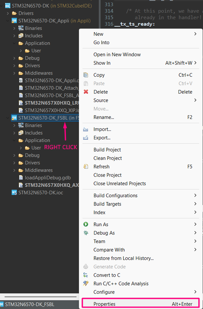

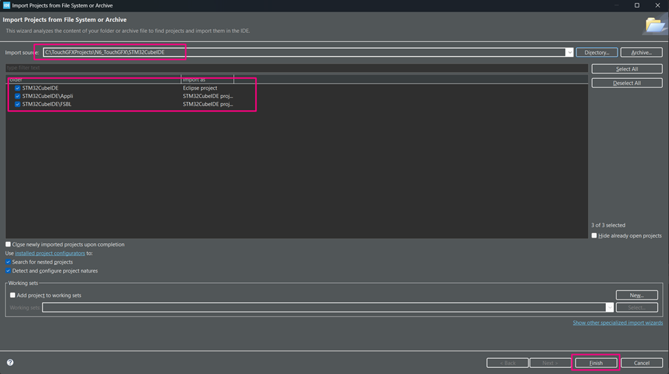

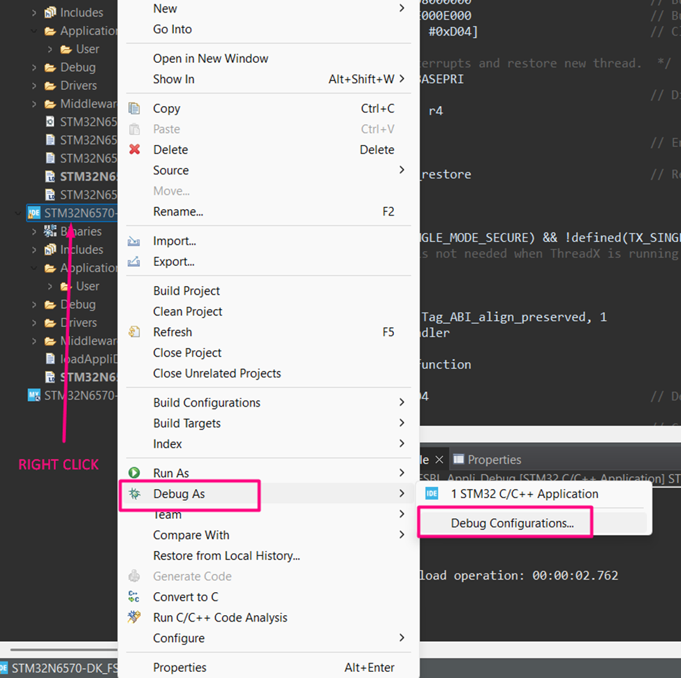

1. Open the project created with STM32CubeIDE. It should include all projects created in the workspace.BMontanari_3-1759934058827.png2. If your board has the default OTP fuse settings, either:

To debug the application on the STM32N6 with TouchGFX, follow these steps:

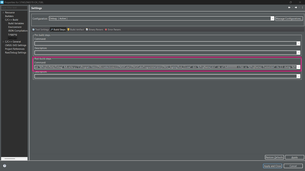

1. Add the post-build step to ensure your FSBL has the signature.
1a. FSBL:BMontanari_5-1759934103916.png
Starting from STM32CubeProgrammer version 2.21.0, a new parameter is needed at the end "-align". Please make sure you use the updated command, as follows:
cd "${ProjDirPath}/Debug" && echo y | "C:\Program Files\STMicroelectronics\STM32Cube\STM32CubeProgrammer\bin\STM32_SigningTool_CLI.exe" -bin "${ProjName}.bin" -nk -of 0x80000000 -t fsbl -o "${ProjName}-Trusted.bin" -hv 2.3 -dump "${ProjName}-Trusted.bin" -align

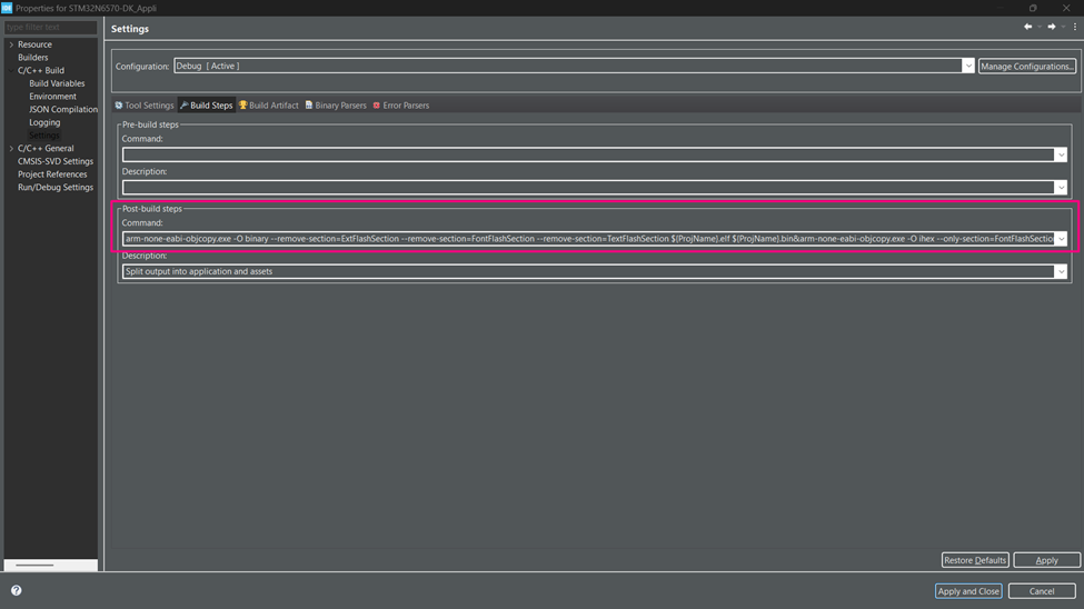

2. Add the post-build step to ensure your application has the signature.
2a. Application:BMontanari_7-1759934193020.png
arm-none-eabi-objcopy.exe -O binary --remove-section=ExtFlashSection --remove-section=FontFlashSection --remove-section=TextFlashSection ${ProjName}.elf ${ProjName}.bin&arm-none-eabi-objcopy.exe -O ihex --only-section=FontFlashSection --only-section=TextFlashSection --only-section=ExtFlashSection ${ProjName}.elf ${ProjName}_assets.hex && cd "${ProjDirPath}/Debug" && echo y | "C:\Program Files\STMicroelectronics\STM32Cube\STM32CubeProgrammer\bin\STM32_SigningTool_CLI.exe" -bin "${ProjName}.bin" -nk -of 0x80000000 -t fsbl -o "${ProjName}-Trusted.bin" -hv 2.3 -dump "${ProjName}-Trusted.bin" -align

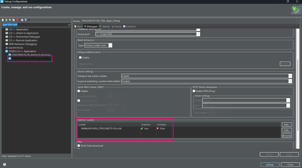

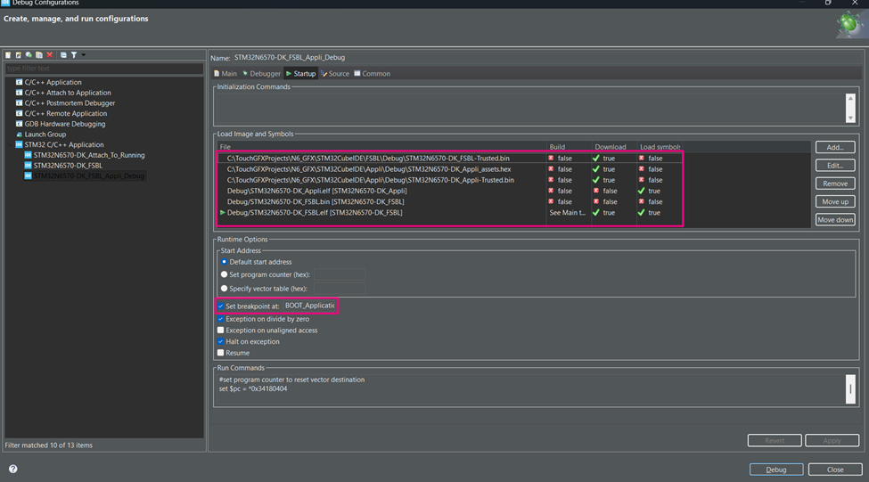

3. Edit the startup sequence in the debugger settings for the FSBL:BMontanari_8-1759934230307.png4. Go to the [Debugger] tab.

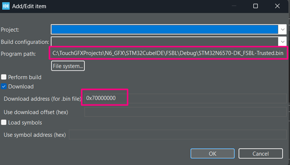

5. In the [Startup] section, ensure that the FSBL ELF file is used. Since this is a debug session, the trusted binary is not required, but we will add it as well.  Add the FSBL-Trusted.bin file to be programmed at address 0x70000000.BMontanari_11-1759934318196.png

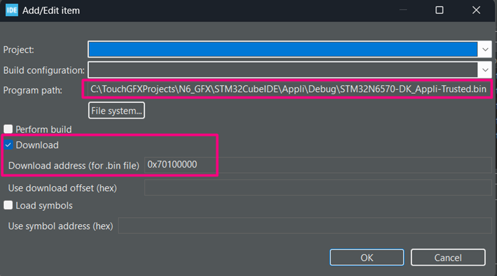

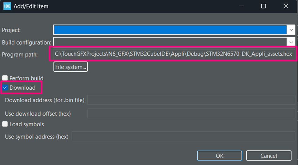

6. Configure the application to load the trusted binary into address 0x70100000 and the image assets using the HEX file. Only download this file; do not load symbols, as they are provided by the ELF file.BMontanari_12-1759934331212.png
This should be the final look of the settings:BMontanari_14-1759934348016.png

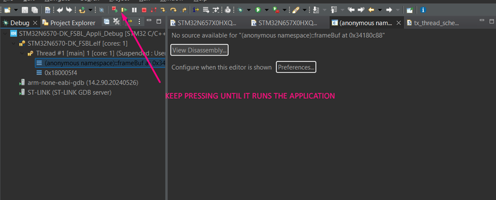

Once in debug mode, you might encounter a few messages before the application runs as the framebuffer is populated. Click Continue a few times if this happens.
Warning: Avoid leaving breakpoints in the application, as this causes the debugger session to fail and display an error message.

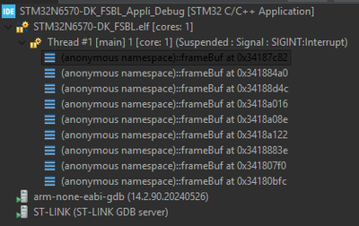

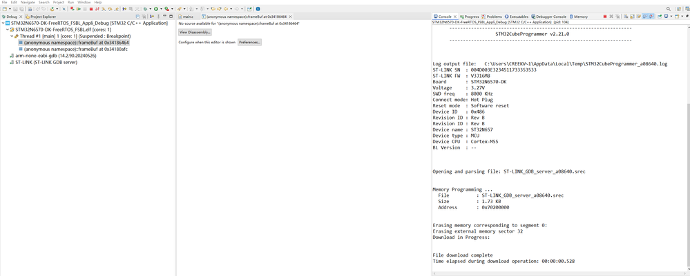

Thanks for this write-up! I am having limited success with this method and I think I'm very close to having it working (it randomly worked once). The frequent issue is what appears to be infinite frame buffering. The thread never exits this state and never seems to reach BOOT_Application. When I click pause I see this. What could be wrong in the setup?

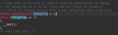

For others, I've managed to work around this by using the "attach-to-running" debug configuration. Build the project then run the flash script which signs the binaries, loads the FSBL, APP, and assets. Boot as normal and debug as "STM32N6570-DK_Attach_to_Running". Make sure the SWD pins are assigned correctly in the APP context (PA13 and PA14).
If you want to debug init code, add something like this in the App project in the beginning of main():

The problem I encountered is the same as @QHarmonics , unable to correctly enter the debug state, and it has never succeeded even once (note: I chose FreeRTOS, not ThreadX)  @B.Montanari Can you give me some help  please @B.Montanari ? This is very important to me.

I appear to be having the same issue as QHarmonics where debugging worked randomly once but not anymore.  I have been successful in programming the FSBL, Appli, and assets then attaching to the running project, but it is a tedious process.  Are there any better solutions to debugging directly?
