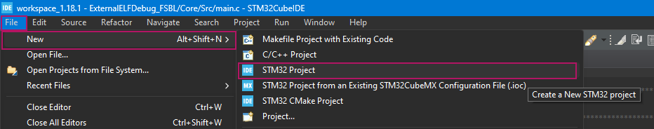

2.2 Generating a blank project in STM32CubeIDE
Create a new project using the STM32CubeMX integration inside the STM32CubeIDE, by clicking [File][New][STM32 Project], under the [MCU Selector] section for your desired microcontroller, in this case [STM32N657X0H3Q]. Once the project is created, press [Ctrl+S] to save the blank project, and the base code is generated.

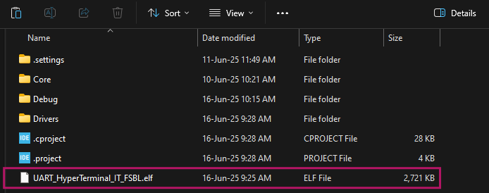

2.3 Debug file location
Place the *.elf file you wish to debug inside the directory of the project generated in the blank project.

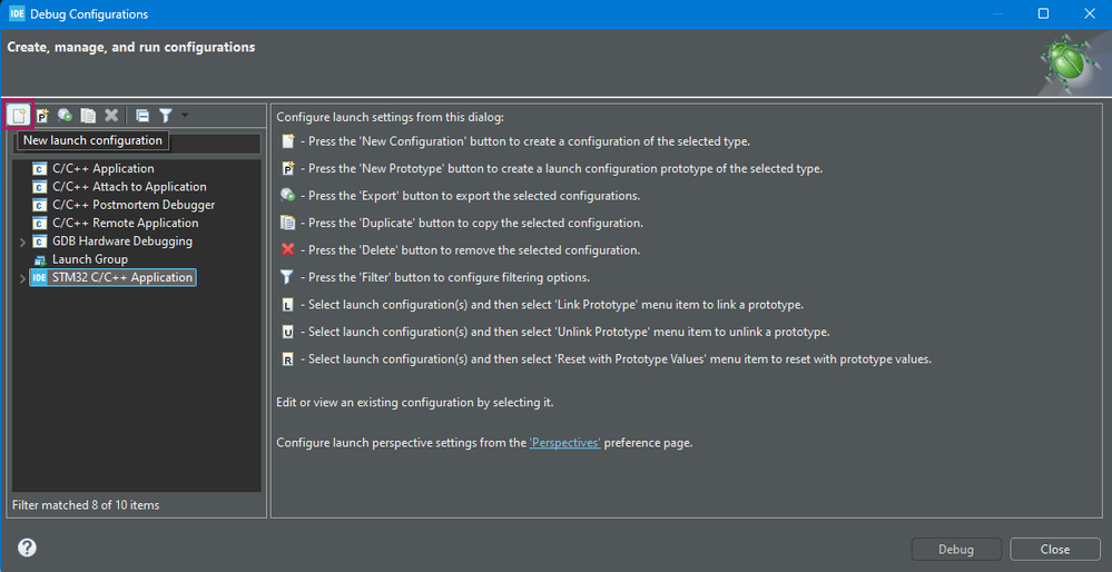

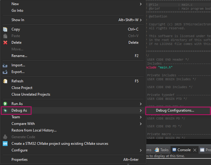

2.4 Debug configuration

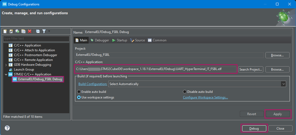

Back to the blank project, right-click on the Project name and then [Debug As] >> [Debug Configurations…].
OBS.: If your current project does not show up under the “STM32 C/C++ Application”, you can just select the “New launch configuration” button and then choose your current project:
Change "C/C++ Application" to your external *.elf with the absolute path (the path from the project generated in Step 2), click [Apply] and then [Debug]:

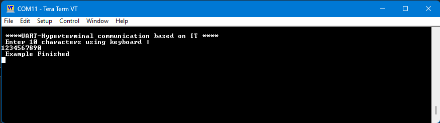

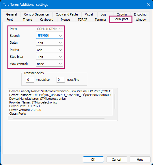

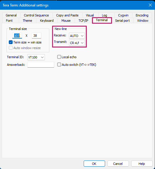

2.6 Validation
To verify the debugging, use terminal emulator software, such as Tera Term or the embedded software available in STM32CubeIDE, with the following configuration:
After setting it up, the code executes as it was intended to:
