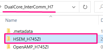

That way your workspace folder is open, and you can see all your project’s folders available for this workspace. After this, you can copy your project’s folder and paste it to any workspace that you wish, even the same workspace as the original project.
For this example, create another workspace just for the cloned project called “Cloned_Project.” In the new workspace folder, paste the project’s folder and change its name. The new project’s name has a “Clone” written at the end to facilitate the identification:

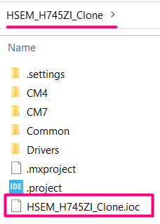

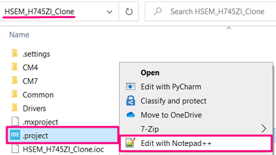

You can use any editor of your choice to do so. In this article, we use Notepad++. Starting with the easiest one to be renamed, you can change the .ioc file just by clicking its name and changing it, like the figure below:

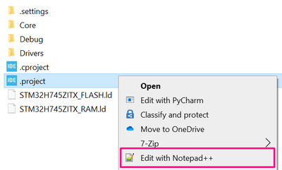

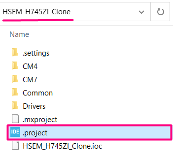

For the .project file, you need to right-click it and choose to edit it with your preferred toolchain, which is Notepad++ in this case:

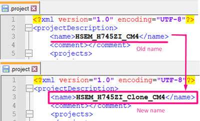

At the Notepad++ editor, you only need to change the project’s old name for the new one and save the file, as the figure below:

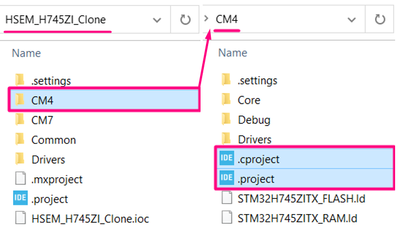

At the CM4 folder, the same procedure is done with the .project and .cproject:
Starting with the .project file, right-click it and select to edit with Notepad++:
For this file you can do the same as the last one, simply by changing the name and saving the file.

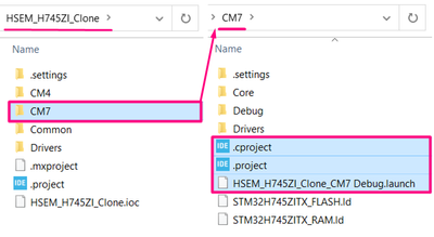

Going to the .cproject, it is recommended to use the "replace" feature since it has four instances containing the project’s old name. You can replace all the instances of “HSEM_H745ZI_CM4” with “HSEM_H745ZI_Clone_CM4” by using the shortcut [Ctrl + H]. Remember to save the modified files.
You can repeat this process for the CM7 folder, by changing the name on the .project and .cproject equally as explained before.
In case one of the cores has a Debug.launch file, such as the CM7 in this project, it means that the original project was already launched or debugged before. You can also change this file’s name by clicking on it and changing it as the image above.
With all these modifications done, you can open the project by double-clicking the .project file (HSEM_H745ZI_Clone\.project). Then, you can give it a build and work with your cloned project as you want.
