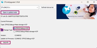

The aim of this section, firstly, is to remove the mass storage capability of the embedded STLINK. When activating the RDP level the mass storage is detected as an interruption and the flash is locked. Secondly, check the blinking LED code example (attached at the end of this article as LED_Blinking.7z.)

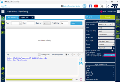

1. Click on [Firmware upgrade]
2. Click on [Open in update mode] and select [STM32 Debug + VCP]
3. Click on [Upgrade]

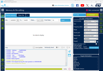

4. Click on [Connect] to connect the board

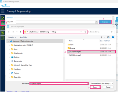

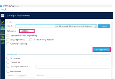

5. Download the extractable file attached at the bottom of the article and add the LED_Blinking.bin as shown in the figure below

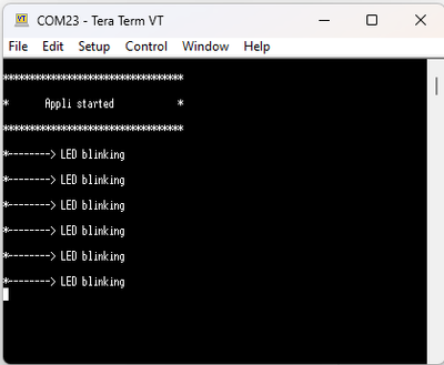

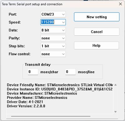

6. Open Tera Term and configure it to check the LED status

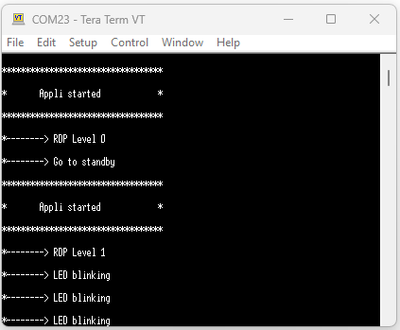

7. Remove the debugger link by removing CN2 ST-LINK jumpers on the Nucleo board, press the reset button, and we can see the led blinking and this message in Tera Term

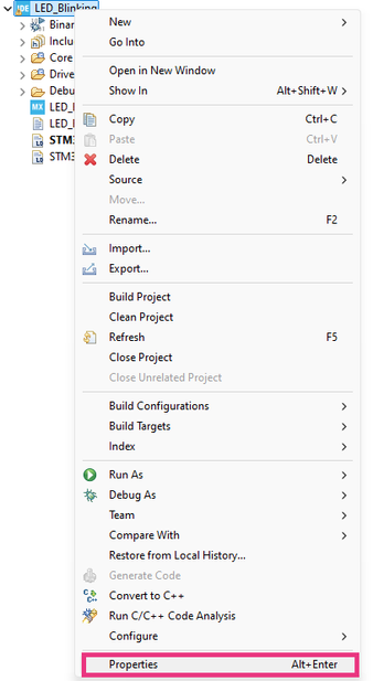

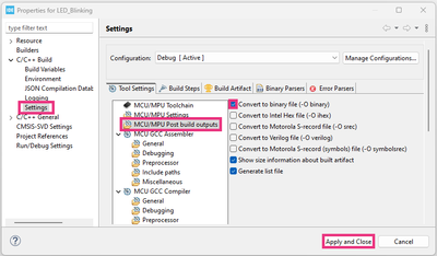

3. Right-click on LED_Blinking project to modify its properties
4. Select [Convert to binary file(-O binary)] to create a binary file as shown in the figure below

5. Add the new binary and click on [Start Programming] in STM32CubeProgrammer
6. On Nucleo-L456RG, remove the debugger link CN2 ST-LINK jumper and press the reset button
You can see in the Tera Term that the RDP level is changing by transition to standby
