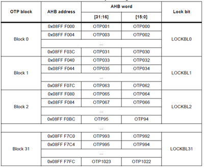

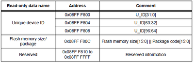

3. RO and OTP areas
The embedded flash memory offers a 2-Kbyte memory area to store read-only data. This area is mapped as described in the below table:
* VREFINT_CAL_ADR, TEMPSENSOR_CAL1_ADDR, and TEMPSENSOR_CAL2_ADDR are located in reserved information
OTP data is organized as 32 blocks of 32 OTP words, as shown in the below table:
It is also important to note that for 8-bit accesses, an AHB bus error is generated. For OTP and RO sectors in memory, a 6-bit ECC code is associated with each 16-bit data flash word. So, the embedded flash memory supports only16-bit or 32-bit write operations. Therefore, the burst access is not supported for these regions.

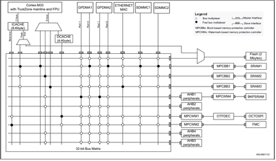

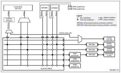

5. How does the cache intervene in access to data in the STM32H5 series?
The STM32H503xx microcontrollers features an integrated ICACHE that combines instructions and data into a single cache. This cache is introduced on the C-AHB code bus of the Cortex®-M33 processor. This is to improve performance when fetching instructions (or data) from internal memories (SRAM1 and SRAM2).
The STM32H562xx, STM32H563xx, and STM32H573xx microcontrollers features:
  • A DCACHE S-bus that connects the system bus of the Cortex®-M33 core to the BusMatrix via the data cache. This bus targets the external memories (FMC and OCTOSPI)
  • An ICache that is connected via the fast C-bus to the internal flash memory and the internal SRAMs (SRAM1, SRAM2 and SRAM3), and it is connected via the slow bus to the external memories (FMC and OCTOSPI)

I've read this 3 times back and forth but still cannot understand ((
So, does the ICACHE in H503xx mean Integrated or Instruction cache?
And why exactly it causes a fault when accessing the RO & OTP area?
The "128-bit cacheline refill" probably is the burst operation mentioned in the article. But how is it related to 8-bit access vs. 16 or 32 bit? Does it mean that any access, even 32 bit, to this area triggers the cacheline load?
How about the main flash array - is cacheline refill OK there?

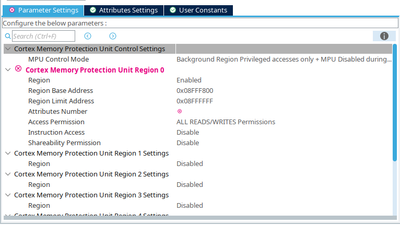

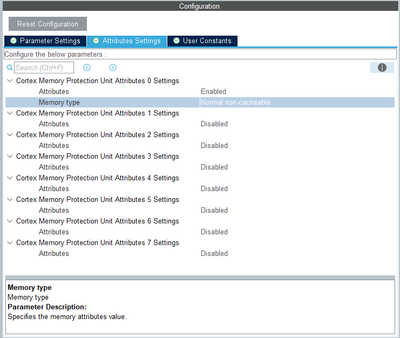

I'm currently developing on a H533RE. I could reproduce the issue (hard fault accessing the tempsensor calibration data) and I could fix it with the suggested MPU settings.
But I couldn't manage to have the MPU configured via CubeMX, for the dropdown "Attributes Number" has a list of non-selectable, greyed-out items (ATTRIBUTE 0..). Hovering the pink cross says:
Please select a new value other than '' from the provided list. Value not found.
Is it a CubeMX bug or my shortcoming?
Using stm32cubeide v1.19 (CubeMX 6.15.0), H5 HAL 1.5.0
Thank you in advance!
Visitor II
Nov 6, 2025 12:39 PM UTC
@oxullo, you need to define the attributes on the next tab, like this:

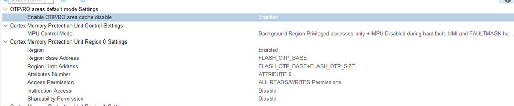

Apr 1, 2026 1:49 PM UTC
Hello, I am trying to do it as well, as soon I read the OTP memory, I go under the NMI interrupt.
I am not sure of you're memory address
region.BaseAddress = 0x08FFF800;
Since the OTP start address is:
#define FLASH_OTP_BASE (0x08FFF000UL) /*!< FLASH OTP (one-time programmable) base address */
Additionnaly, there is now a setting to disable area cache "OTP/RO areas default mode settings":
void OTP_InitProductionConfiguration(void)
bool continue_check = true;
do
ProductionConfiguration * currentProductionConfiguration = (ProductionConfiguration*) otp_flash_address_;
if (0xFFFFFFFF == (uint32_t)currentProductionConfiguration->acc_bias_x && 0xFFFFFFFF == (uint32_t)currentProductionConfiguration->acc_bias_y)
/* There is no more data programmed - stop searching */
continue_check = false;
else
current_production_configuration_ = *currentProductionConfiguration;
otp_flash_address_ += sizeof(current_production_configuration_);
} while(continue_check);
