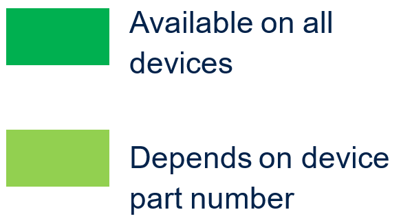

STM32 MCUs featuring the empty check mechanism
The following MCUs feature bootloader activation patterns 6, 11, 13, 16 as per AN2606:
STM32 Series STM32 MCU
F0
  • STM32F04xxx
  • STM32F070x6
  • STM32F09xxx
C0
  • STM32C011xx
  • STM32C031xx
  • STM32C051xx
  • STM32C071xx
  • STM32C091xx/92xx
G0
  • STM32G03xxx/STM32G04xxx
  • STM32G05xxx/061xx
  • STM32G07xxx/08xxx
  • STM32G0B0xx
  • STM32G0B1xx/0C1xx
L0
  • STM32L01xxx/02xxx
L4
  • STM32L412xx/422xx
  • STM32L43xxx/44xxx
  • STM32L45xxx/46xxx
  • STM32L496xx/4A6xx
  • STM32L4Rxxx/4Sxxx
U0
  • STM32U031xx
  • STM32U073xx/83xx
WL
  • STM32WLE5xx/55xx
WB
  • STM32WB10xx/15xx
  • STM32WB30xx/35xx/50xx/55xx
