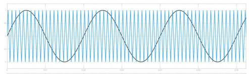

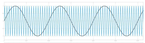

The idea is to generate a digital signal from a timer output (PWM mode) on an STM32 and use an external RC filter to convert it to an analog sine wave. For simplicity, a basic low pass filter is used as shown below for the conversion. While this article focuses on the basics of generating the digital signal, please consult other resources for details on RC filters.
We will generate a custom signal like the one in red shown below using the STM32 Timer PWM output channel:
Then using a RC filter connected to the output of Timer PWM output channel, we will get our desired Sine Wave:
We will be using the center aligned timer mode to generate a custom signal using PWM and DMA. This can be done with one method of combining the STM32H7 timer with the internal DMA feature. This method will use the DMA to transfer the continuous data of a sine wave output to the timer CCR register.  The timer CCR register controls the width of the PWM duty cycle. This will produce the resultant gate drive signal at the timer output pin. When using the DMA hardware to transfer the continuous data to the timer, the Cortex-M core is free to process other application functions in parallel. We can generate any custom waveform by feeding the data of that signal to the timer CCR register via DMA. In this exercise, we will be generating a sine wave.

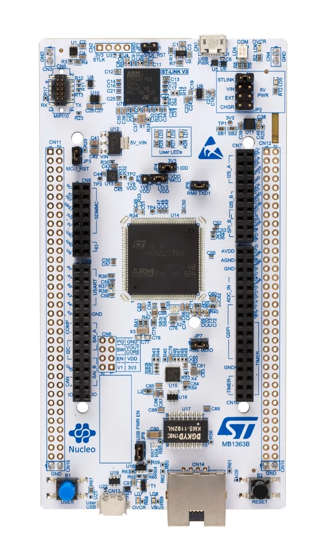

NUCLEO-H745ZI-Q:

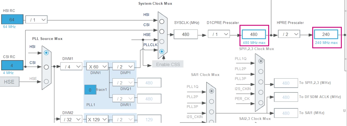

  2. Clock Configuration: 480/240 MHz
We are running the STM32H7 at its maximum speed: 480 MHz for the System Clock and 240 MHz for the peripheral clocks.

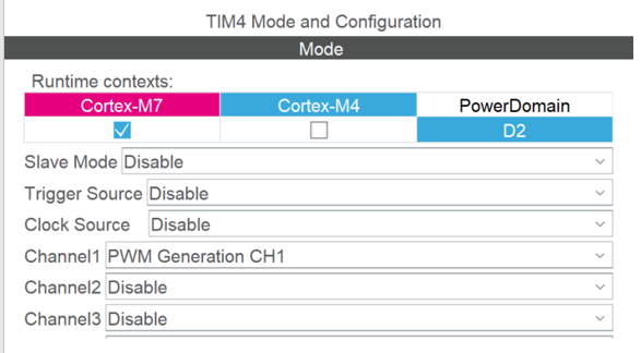

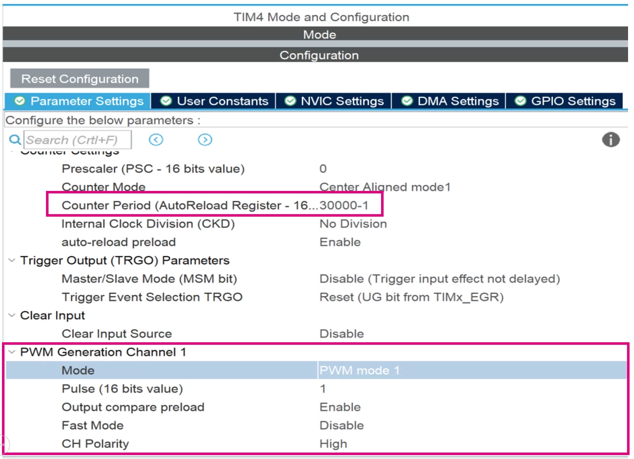

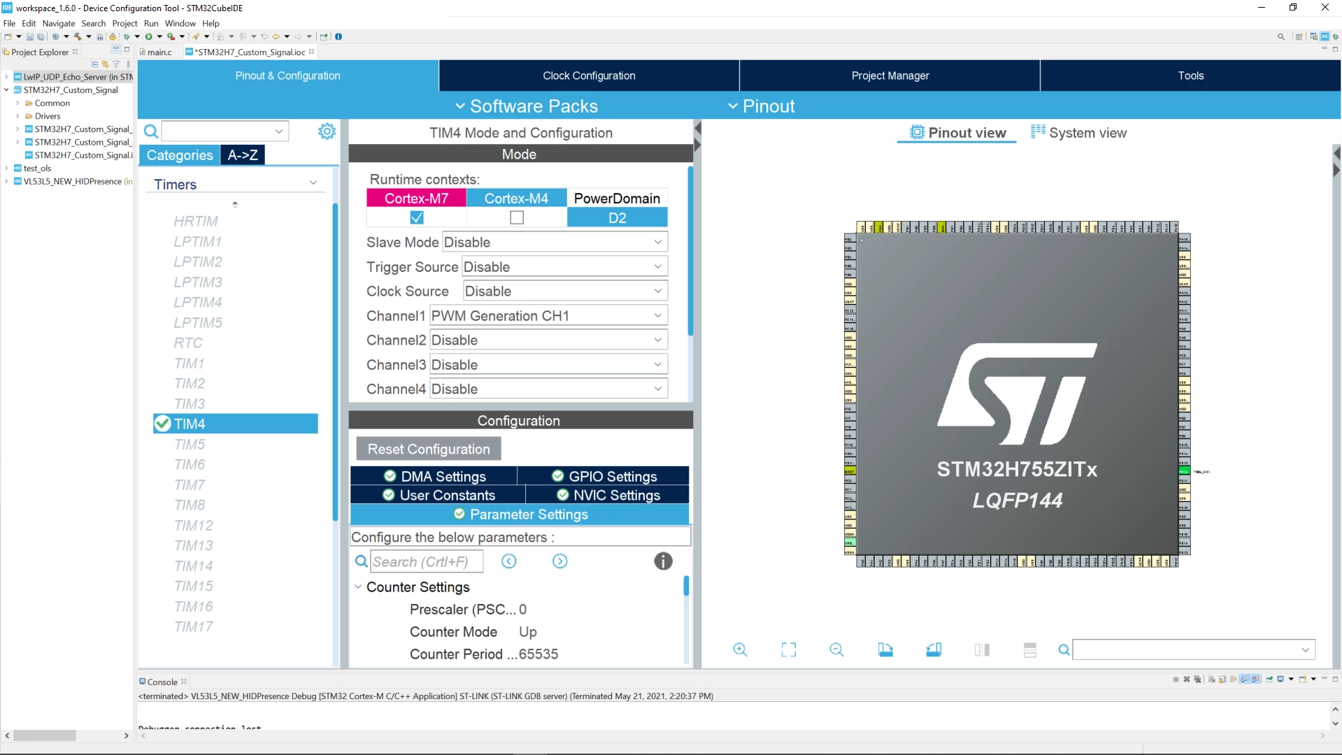

  1. Timer 4 configuration
  •  Enable TIM4
  • In configuration mode, select Cortex-M7 and select PWM Generation CH1 for Channel 1:
  • Add the following configuration

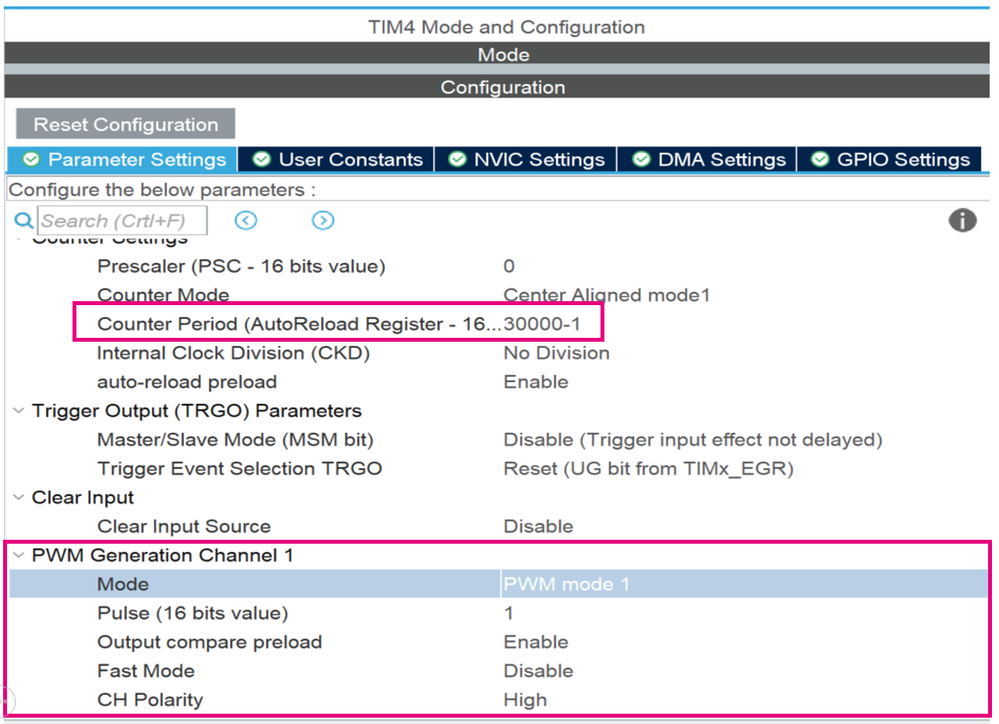

In this section we select the frequency of the PWM signals that we will generate.
Please change the counter period as shown highlighted in red below.
Also configure the PWM Generation Channel 1 as shown in red below.
Note: While the PWM is configured to have an initial pulse width of one count, the DMA will be responsible for writing the values from the table to generate the desired pulse train.

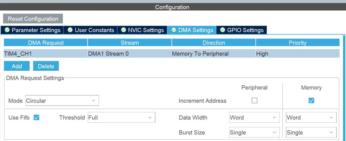

  1. DMA configuration
We use DMA in this case, as this is the most optimal method for generating the signal accurately. In this case, the CPU is not used and can take care of other tasks.

  2. Run the code by resetting the board using the black reset button B2 on the Nucleo board

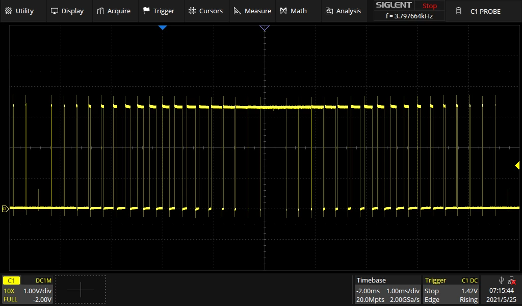

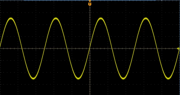

4. Results on the Oscilloscope
Output of the custom PWM signal from TIM4 CH1 (GPIO Pin PD12) is available on the Nucleo board on connector CN10, pin #21 (see the image below).

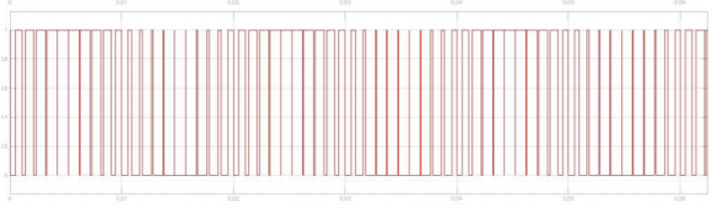

Oscilloscope capture on PD12:
When adding the external RC filter to the PWM output, the signal is converted to a sine wave as shown in the following oscilloscope capture:

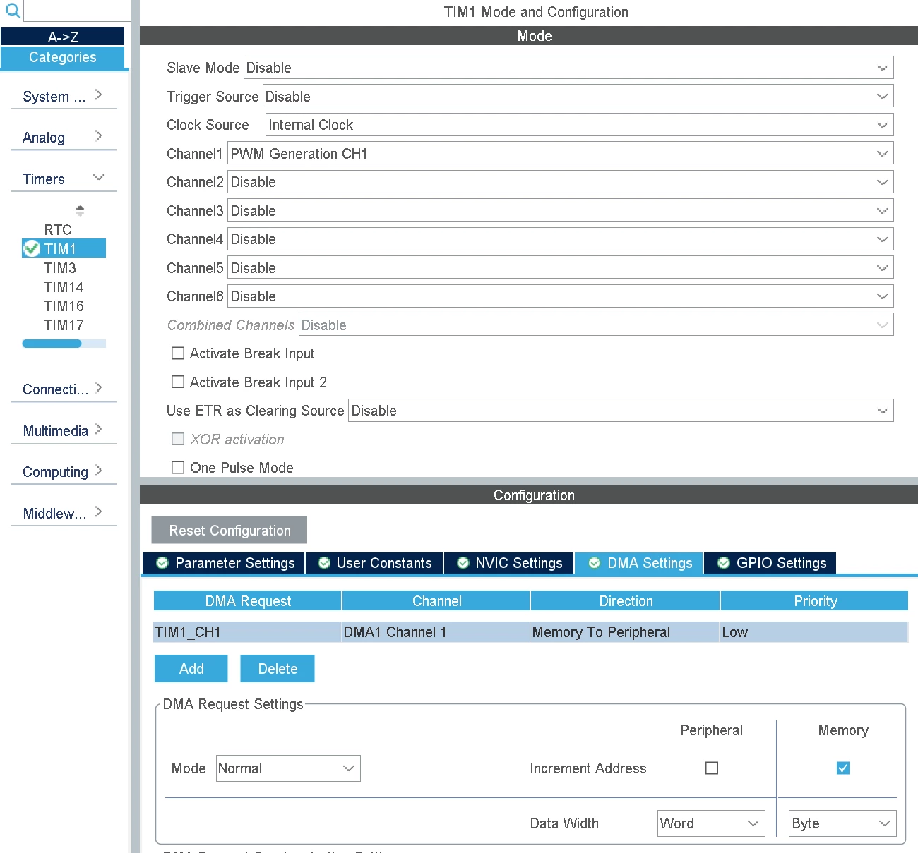

A simple project on a stm32G030C8Tx
A bit of an issue with a single transfer if you set up CubeIDE for a Normal Mode in the DMA settings then the PWM is left running at the last value in your DMA memory array in this example the
 So if I genererate a CubeIDE project with
Channel1  PWM Generation CH1
Prescaler 10
Counter Mode Up
Clock period 255
Internal Clock Division No Devision
Repetition counter 0
auto-reload preload 0
DMA Settings
TIM!_CH1          DMA1 Channel 1       Memory To Peripheral         Low
DMA Request Settings
Mode Normal
Increment Address Memory and Not Peripheral
Data Width
Periperial Word
Memory Byte
/* USER CODE BEGIN 2 */
//TIM1->CCR1 = 4;
//HAL_TIM_PWM_Start(&htim1, TIM_CHANNEL_1);
uint8_t pwmData[10];
pwmData[0] = 25;
pwmData[1] = 50;
pwmData[2] = 75;
pwmData[3] = 100;
pwmData[4] = 125;
pwmData[5] = 150;
pwmData[6] = 175;
pwmData[7] = 200;
pwmData[8] = 225;
pwmData[9] = 250;
HAL_TIM_PWM_Start_DMA(&htim1, TIM_CHANNEL_1, (uint32_t *)pwmData, 10);
