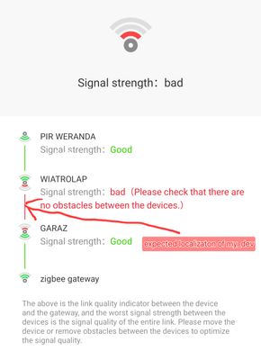

Hi. I`m using Zigbee_OnOff_Router_NVM example on WB55CGU6 custom board with existing Zigbee network in my home, but seems that my device not act as router. I mean that it not extends range of my network. What i do wrong?

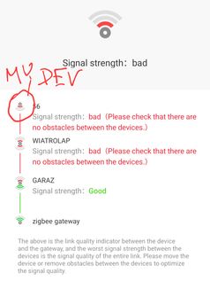

Thank you for your response, @STTwo-32. I agree that the application is working correctly and I have no errors. I posted the logs for informational purposes. As I mentioned earlier, my problem is that I cannot confirm that my device is functioning as a router in my home Zigbee network.
The image on the right shows the actual situation, where My_Dev is physically located roughly halfway between "WIATROLAP" and "GARAZ", but it is not visible in the Tuya app. Therefore, I conclude that it is not functioning as a router.
Thanks for support.
‎2025-01-09 12:50 PM
I have tried many things regarding this topic, and it seems that with the Tuya application, only the on_off_switch is visible and responds to callbacks, meaning that it's possible to activate the output using the button in the application, and that's about it. This topic is explained quite thoroughly on the forum: https://community.st.com/t5/stm32-mcus-wireless/stm32wb5mm-dk-connecting-to-tuya-gateway-with-zigbee-part-2/td-p/630003
