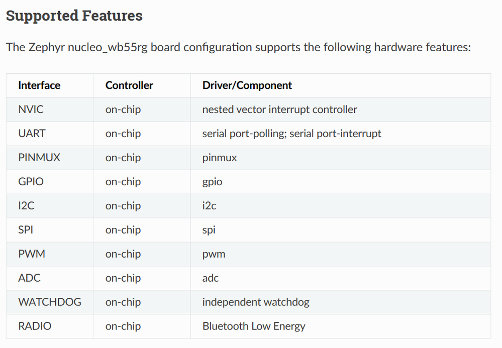

I am beginner with STM32WB board and would like to know whether only the co-processor libraries from STM should be used for the Radio core or is it possible to use third party sources for radio programming. Further I wish to do 802.15.4 programming with Zephyr RTOS. Right now, Zephyr does not support 802.15.4 for stm32wb boards. Any leads on how to port to the existing driver to this board?

What do you mean by >would like to know whether only the co-processor libraries from STM should be used for the Radio core or is it possible to use third party sources for radio programming.
Zephyr is supported by STM32WB. See this link.

Thanks for your response. Yes STM32WB board is supported by Zephyr. But I could not find support for 802.15.4 feature. So if I want use to use 802.15.4 of stm with Zephyr could you please guide me on how to achieve it?
